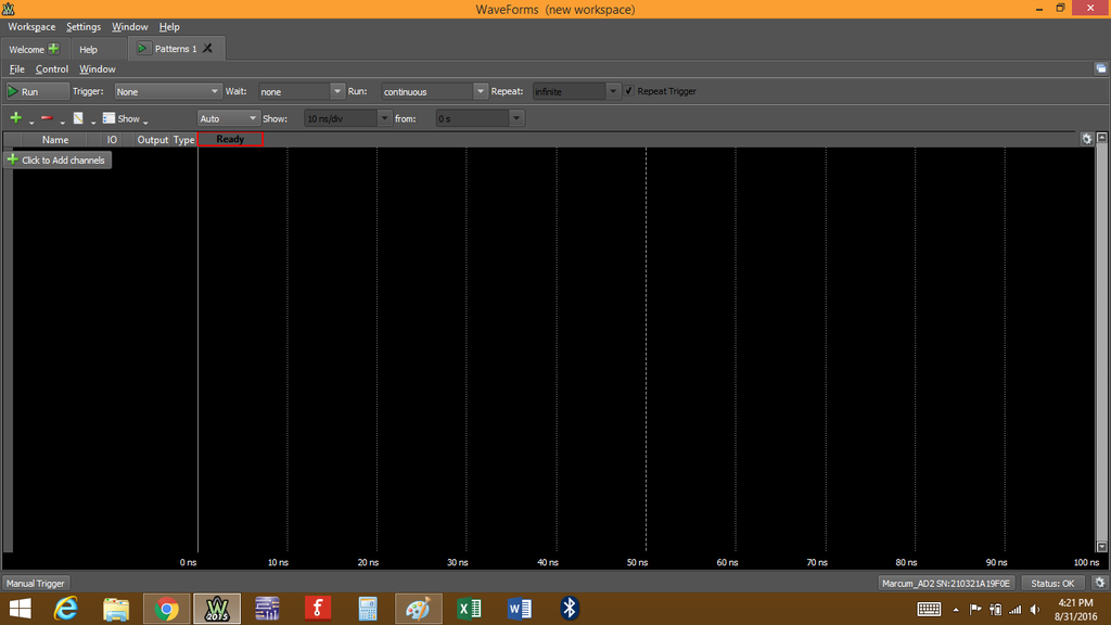

Once you have your AD2 and Waveforms all set up, open the Pattern Generator by clicking on the "Patterns" button.
The Pattern Generator window will open.
There are three main tool bars along the top, the first with "File", "Control", and "Window" options.

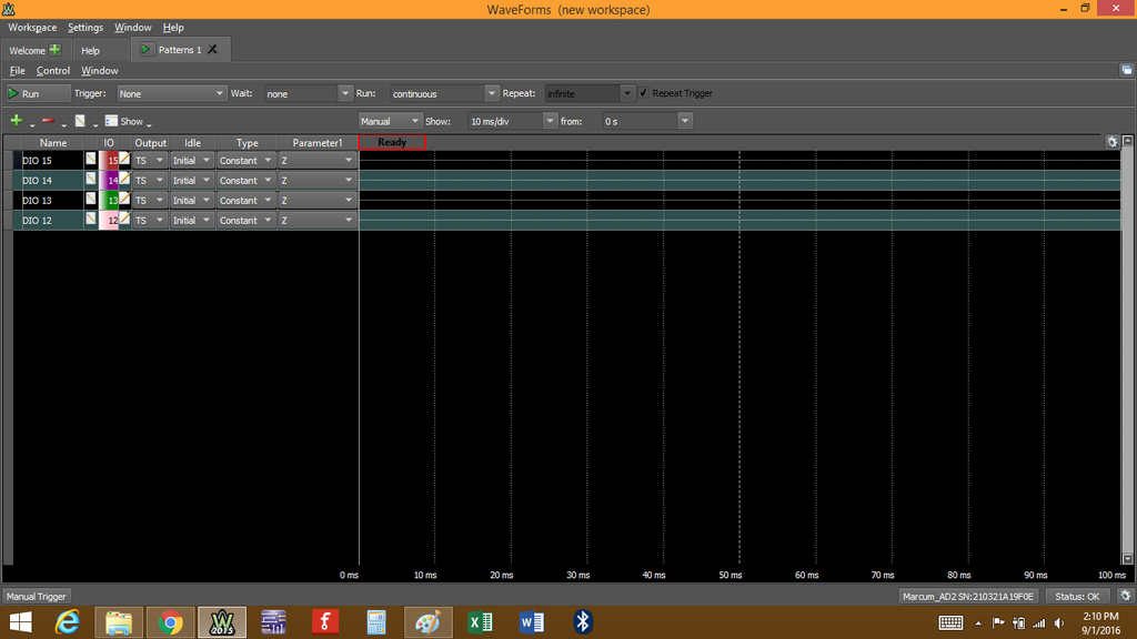

Clicking "Signal" opens a small window that lets you pick which channels you want to add as single signals. Any channel can be added in any order. You can add several channels at once by holding either the "Shift" or "Ctrl" buttons on your keyboard and clicking on additional channels to highlight them. For our example, let's add 4 single signals, channels 15-12.
Click "Add" to add the selected channels to the list. It should look like this.
When the new channels appear in the grid, you'll see various options to further define the channel. Don't worry about these options just yet. We'll get to defining each channel in the next step.

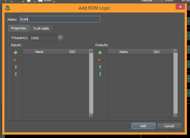

The last signal option is ROM Logic, which can be used to visualize truth tables and test state machine logic. Select "ROM Logic" to open the configuration window.
At the top you can rename the ROM Logic channel in the box.
lets you determine the sample frequency of the inputs. If the change of state on the input happens faster than the sample frequency, the output will likely not register the correct value. Be sure to set your sample frequency higher than your expected input frequency.
On the left you have the "Inputs" window, while on the right you have the "Outputs" window. For both windows, click on to add channels. lets you delete the selected channel, while and let you move channels up and down in the window.
Click and add DIO 8 and DIO 9 as Inputs.
Add DIO 11 as an Output. Don't click yet because we have to define the truth table.
If you want to rename the DIO channels, double click on "DIO x" under the "Name" column, where x is the DIO number. For our example, let's assign "A" to DIO 9, "B" to DIO 8, and "C" to DIO 11. Once done, the ROM Logic configuration window should look like this.

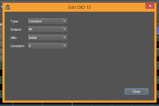

The first column is "Output". Depending on the type you have selected in the type column, there will be up to four options in this drop down menu. "PP" stands for push/pull, which is a full swing 1/0 signal. Next is "OD", which means open drain. The signal will swing between 0 and Z, which is an undetermined value by definition. (My testing with my AD2 shows Z at just a few millivolts, but not a true 0 nor 1 value.) Next we have "OS", which stands for open source. The signal swings between 1 and Z. Last is "TS" which is three-state. The signal can be either 1, Z ,or 0.
The next column is "Idle". You can set the value that the AD2 will output on the DIO pin while the tool is not running. This setting is independent of the other settings, i.e. you can output a 1 while idling even though you have the channel set to open drain, so be aware of how this is set to avoid shorting. The possible settings are "Initial", 0, 1, or Z.
Next is the "Type" column, followed by up to three Parameter columns. Here you can set what type of signal you want to output, along with its possible parameters. Single channel signals can be set to:
- constant, where the signal is set to 1, Z, or 0 and holds that value indefinitely.

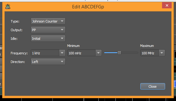

- Binary counter, which is a simple binary counter, or Gray counter, which counts up/down by only allowing one bit to change at a time between sequential numbers. Click here for more on Gray code/counters. Both Binary and Gray counters have the same settings options. You can set the frequency, which is the rate at which the LSB will toggle high/low, the initial value where the counter will start for the first count cycle, and whether it counts up or down. The counter can count up to or down from 2n, where n is the number of channels assigned to the bus. Once the max value (up) or 0 (down) is reached, the counter will start over from the beginning, ignoring the defined initial value from then on.
- Johnson counter, also known as a ring counter and is a variation of gray code, which adds one channel at a time, starting with either the LSB (left direction) or MSB (right direction), until all channels are on. Each channel is then turned off one at a time, again starting with either the LSB or MSB, until all channels are off. The cycle then repeats. There are a total of 2n possible combinations for a Johnson counter, where n is the number of channels assigned to the bus. Click here for more on Johnson counters.

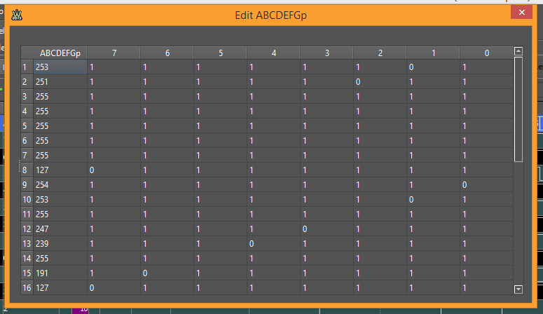

For the bus "ABCDEFGp", open the "Parameters" window for the bus. Set the bus to "Custom" type, "PP" output, "1" idle, 1.6 kHz frequency and "32" samples. The easiest way to set this bus is to use the data table. Click and drag it to the left to extend the data table. Starting with row 1 under column "ABCDEFGp", you can enter the bus value for that sample. How you enter this value is determined in the bus "properties" window. We selected "decimal" format before. You can also set each bus channel individually if you choose.
If you're not familiar with multiplexing LEDs, the idea is to turn only one segment on at a time, but cycle through all of them so fast that you can't see them flashing. The first digit will display the number "1" and the decimal point. To make a "1" on a 7-segment, we need to light segments B and C. Row 1 is set to "253" (0b11111101) to set segment B. Row 2 is set to "251" (0b11111011) to set segment C. The next 5 rows are set to "255" (0b11111111) to keep all segments off. Row 8 is set to "127" (0b01111111) to turn on the decimal point. Since there are a total of 8 LEDs, row 9-16 are the segment assignments for digit 2. Rows 17-24 are for digit 3, and rows 25-32 are for digit 4. I've included two images to show the full table below with both decimal and binary values.
