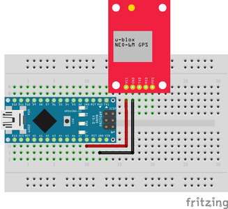

Step 1: GPS Location FIX
First hardware
The first thing we check: does the GPS get a location FIX ? Just put the Nano and the GPS in your breadboard and wire the GND and VCC PIN. The Nano 5V PIN has 2 functions:
  • From USB you can power low current devices
  • If you have an external 5V powersource you can power the Nano. My advice is never to use the VIN PIN, the on-board power regulator sucks.
No code here, we just use the Nano as a powersource for the GPS. Connect the Nano to USB [PC, laptop, phone charger, powerbank, etc.] Both power LEDs should turn on, and we wait for the GPS to blink. On the photo above you see a small GPS board, used in drones and other mobile devices. It works fine outdoors, but for indoor usage it's not good enough.

The NEO-M8N in the photo below is actually a multi GNSS chip, which uses GPS, Glonass, Galileo, etc. We use it with its default factory settings in the whole project. Any GPS board will do, as long as you have 5 PINs: VCC, GND, Tx, Rx and PPS.

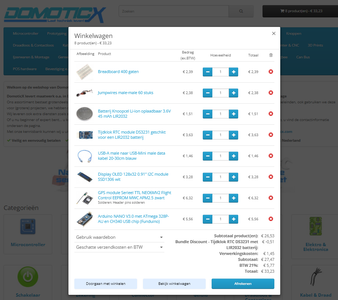

Step 10: Budget Clock Version
If you are new to Arduino and have to start from scratch, buy pre-soldered parts. This saves the extra tools needed.
It uses a tiny 128x32 OLED I2C display and the GPS unit in STEP 1.
