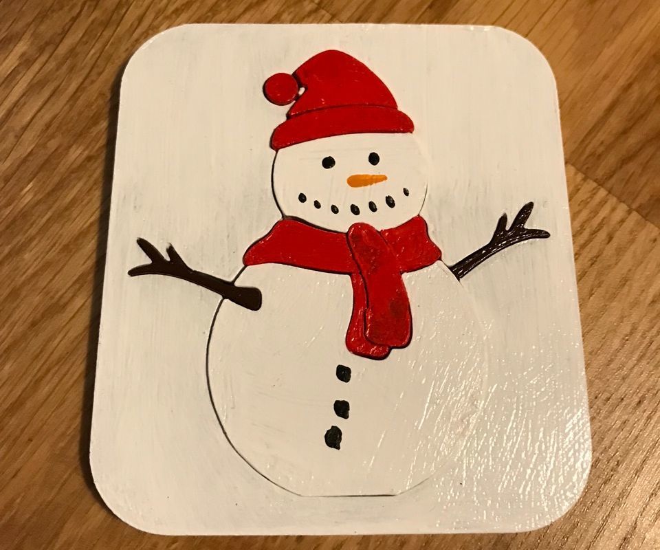

I wanted to paint the houses' numbers with a gold paint using some stencils and I am quite frustrated when I see the result. The cheap stencils I found on Amazon (the only one I could find actually) produce some bleedings. The ideal would be to create our own stencils that stick to the model... I definitely need to invest into a home cutter.
After many layer of white paint on the snowflakes, the result is very good. The filament layers add a snowy touch to the piece.
