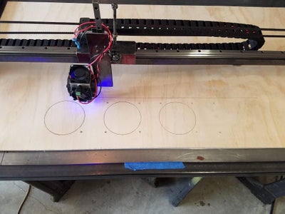

This is a CNC diode laser table. It is not fast but it can cut big projects. Its made of steel since its way cheaper than extruded aluminum and it is an exercise in bumbling through the unknown. When I started building this laser I had no idea what I was doing but figured heck its possible, people have built them before it is time for me to give it a try.

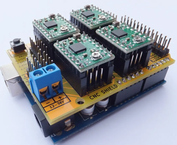

To have a CNC machine you need to have a computer. Computer's don't interface well with machines that don't use USB.
The Arduino and CNC shield.
The kit I bought off of Amazon had everything short of the tool and linear bearings to make a CNC. If you are familiar with Instructables I bet you have seen an Arduino before, they make a CNC shield that most people use to make 3d printers using a program called GRBL.

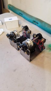

What motors did I get

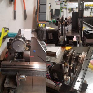

The kit came with Nema17 stepper motors, I had no idea what that meant at the time but googled it up. Steppers precisely control pitch and have high torque these motors have 200 steps per revolution so they can natively control 1.8 degrees per step. I wanted to gear it down so I had a 3/1 reduction, this would give me .6 degrees per step and up my torque without having to use half steps. I will explain half steps later when we talk more about the board.
To get the gear reduction I used GT2 belt and gears, the drive gear is a 20 tooth gear that is belted to a 60 tooth gear giving me a 3 to 1 reduction.

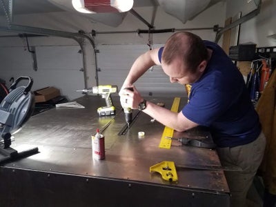

Step 3: Making the Base
The base is 10 gauge steel, roughly 1/8" thk. It is way overkill but from my limited experience with machinery, a heavy base helps keep everything accurate.
How big to make it?
You need to have enough room to have your belts clear the sides of the work surface and allow your laser to to reach edge to edge without hitting anything. For my project I found about 4" on either side gave me enough room to mount my motors and I figured 3" on the bottom would give me enough for the head of the laser.
To lay this step I placed a 2'x4' piece of wood to simulate my part then I cut out I cut 2 48" long 1.25" square tubes to act as my left and right side. Clamped one square tube to the far side and move my parts around until I figured I had enough room. As I said earlier this turned out to the 4" and 3". Once I was happy with this I marked my sheet metal and cut it with a circular saw. A standard circular saw can do amazing work with a metal cutting blade.
After the base plate was cut I cut the 2 remaining square tubes to frame in my base plate and stich welded 1 on 12 skip weld. I did this as the weld is plenty strong for what I am doing and I didn't want the material to warp with excess heat. I figured I could seal the project with caulking at the end.

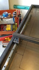

Step 4: Making the Gantry
What do the axises move on?

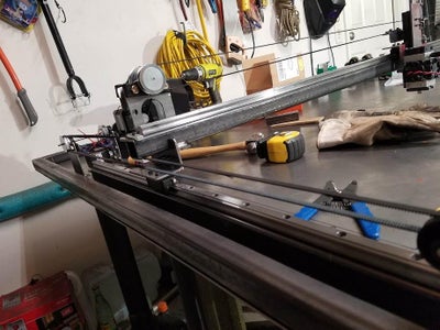

For smaller projects, I have seen rods and that that is what my 3d printer runs on, they work well for short runs but long distances they tend to move due to not being supported. I chose a linear bearing, a cheap one from Amazon, not the multiple hundred dollar options you can get for real CNC machines. I made a decision a while ago that I was not going to make this thing accurate down to 1/128th of an inch. If I get 1/32" accuracy I would be happy. Making this decision drops the cost to around 1k opposed to several thousand dollars. Keeping precision over a long distance gets exponentially more expensive.
Y-axis bearings
I took the same 1.25" square tube and used it as a mounting rail for the bearing. Layed a line down the square tube marked and tapped the holes. To make the Y-axis square to the base I used 2 small pieces of 1.25" square drop at a spacer and clamped it to the side of the frame of the base. Then tack welded it into place. I repeated the same step for the other Y-axis bearing. I wasn't too worried about the two bearings being 100% parallel. I will explain that in a minute.
X-axis bearing
The X-axis bearing bridge is only hard mounted to the left side Y-axis, the right Y-axis bearing it sat in a U shaped pocket that fits very tightly. This is done for a few reasons, the first is with only being bolted to the left Y bearing makes the assembly easier to disassemble. The other reason is if the 2 Y-axis bearings are slightly out of parallel I have a slip joint that will not cause a bind.
Won't this cause crooked cuts
Technically yes but it will be so small I have yet to see anything I can measure. This is because I have 2 motors moving the Y-axis on either side of the bridge.

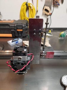

Step 5: Laser Mount
Time to mount the laser.

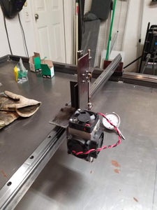

I purchased an Endurance 10watt laser. This laser is designed to be able to retrofit on 3D printers so it has a simple bolting pattern to the back of the laser, the diode and fans come pre-assembled I just have to bring power to both the diode and the fans separately. The complicated part comes with the fact that using different lenses you have to adjust the height of the laser to focus it on the product you plan on cutting. Also the thickness of the product you have to adjust for this too.
I chose a manual Z adjustment
I know I could have gone with a cool stepper actuated adjustment I chose a simple manual method, I figure I once I set the height I won't be changing it for a while and a manual set up will be lighter and simpler. For the adjustment, I chose a 6" linear bearing with a 1/4" ACME thread screw to screw 6" long for my up and down adjustment. Once the height is set I would just screw down the free nut to lock it in place. Later I decided to weld another nut to the top of ACME thread so I can use a ratchet to quickly move focus the laser.

X-axis control is made with the same 20 to 60 GT2 pulley. Instead of having the bearing mounts to the front and behind the motor I opted to put both on one side of the motor. This is also where welding the assembly helped. I was able to weld it to the top of the angle web, something I couldn't do with extruded aluminum.

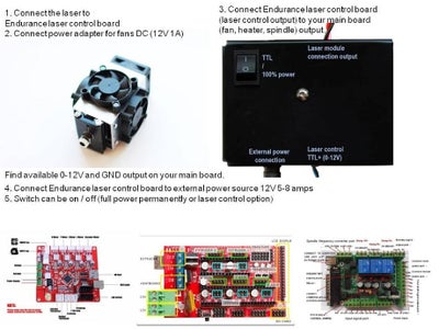

Wire the laser
The laser I purchased has a control box for it, it takes 120v in for power and uses a 0-5v signal to power the laser. The hardest part for powering up the laser was finding out where to land the control on the Arduino board. If your trying to find it this on the internet I will save you the time. Wire the 0-5v signal to the Z+ end stop plugs if your using a CNC shield. At this time the laser turns on and I was happy the main part of the machine works. Still not the time to start burning.

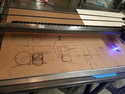

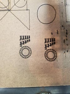

Testing Testing Testing

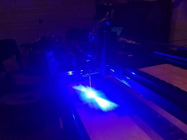

Several days of testing followed, I found I developed a problem where the Y-axis it would not return correctly. I found that the pulleys would rotate on the bearing bar. This was fixed by filing small flats where the set screws would mount.
Also using the cutting lens I had to get very close to the wood to cut, while it worked it was so close I easily got debris building up on the lens. I searched and found a G-7 lense that would allow cutting at a farther distance from the wood ~6cm away. Since then I have had no issues.

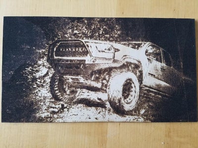

One of my friends loves his Tacoma so for his birthday some of our friends asked I could burn an image of his Tacoma for as a gift. I was feeling confident, I mean I could burn a circle how hard could it be. It was extremely hard to do. I learned a lot about my machine and how to burn an image. Due to the clandestine nature of this project, I have minimal pictures as I didn't want to any chance of sharing an image on Facebook of my progress and having a half image of a Tacoma in the background. This project was worked on for about 3 months until I got a good image.
Things I got out of this:
  1. The stepper controllers do overheat if you don't have a fan on the heatsinks and they loose steps.
  2. There is a small zone of not burning, burning an image and a black blob.
  3. Images are really slow with my laser due to somewhat slow travel speed. Burn throughs are iffy, seems like the low-end movement is too high.
Fixes
  1. I printed a duct for a 30mm fan to blow on the steppers.
  2. Burn black as you can but use stippling, works like how a newspaper prints an image.
  3. The higher speed I just had to drastically up the max movement speed of the machine. The low end was a bit harder to fix. Found out that upping the micro steps from 1 to 1/16 allowed my low-end movement speed to drop very low. Went from ~4.9 steps/mm to ~49.9 steps/mm.
The biggest issue is getting the reliability up for a continuous 6-hour project. Due to the nature of the test, I would only get 2-3 attempts a week. One thing that significantly helped reliability was using a program called Lightscribe, a very user-friendly UI that made the work easier set up. Also while the computer doesn't need to be exceptionally powerful you want to have a dedicated computer for the project. If you are doing something as simple as using chrome and you cause a small communication error to the laser due to any issue you might as well toss out the project. I even go as far as turning off wifi so there are no chances of background updates.

Since this is my first 3d built item it I cut was a bit of a learning curve, burn 1 (image 1 here) you can see I had straight edges, this did not want to go together. Burn 2 (image 2) I used tongue and groove to lock it together and it is set up for 6 120mm fans. I should exchange out the air in the box every 10-20 seconds.

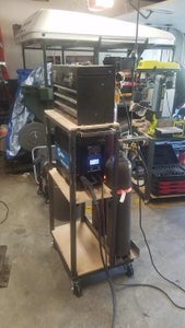

Step 16: Getting the Machine to Stand on Its Own
