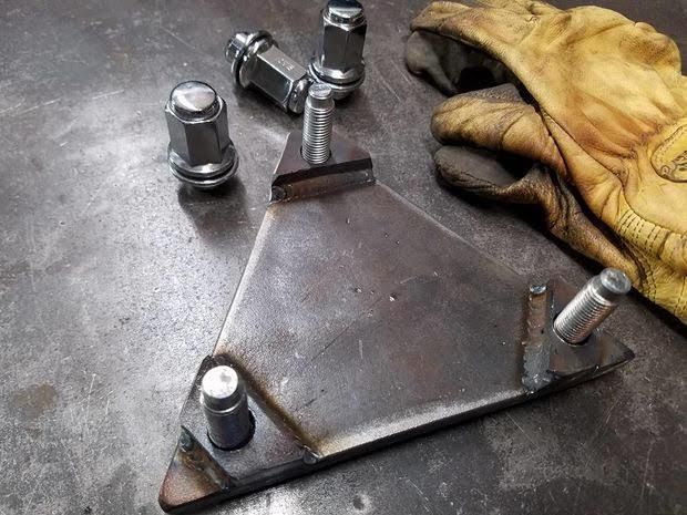

Very few vehicles are designed to have a constant heavy load on them. If the vehicle designed for this, they are commonly not designed to take the vehicle off road, especially under load. Take for example our F-250 has nearly no up travel in the front suspension from factory. This is fine for a road truck but not one that will spend a significant part of its life in the dirt.
When we got the vehicle it already had the flat bed and the bumper. Two things we wanted to add anyway. It had small worn tires on it and while ok rims were not great. We choose to fix these issues with an off road quality suspension from Carli. We went for the shortest lift possible to fit a 35" tire. Suspension doesn't really give you ground clearance in a solid front and rear axeled vehicle, the tires do. The carli lift was a 3" suspension but unlike a lot of other lifts it offers a lot of suspension travel nearly the same as other brands 5 and 6" lifts. Remember this is going off road and off camber (side slope) is part of off road. Off camber leads to roll overs. The rear also has to take a large constant load. We opted for a complete leaf replacement for a constant 1k load. We also chose better rims and mud terrain tires. This thing is going to be every bit of 10,000 lbs. We don't want it getting stuck, we would rather take a cost and mileage hit from going to mud terrain from all terrain tires. Method rims has documents stating their rims take 30% more force to de rim their rim combined with Nitto mud terrains.
