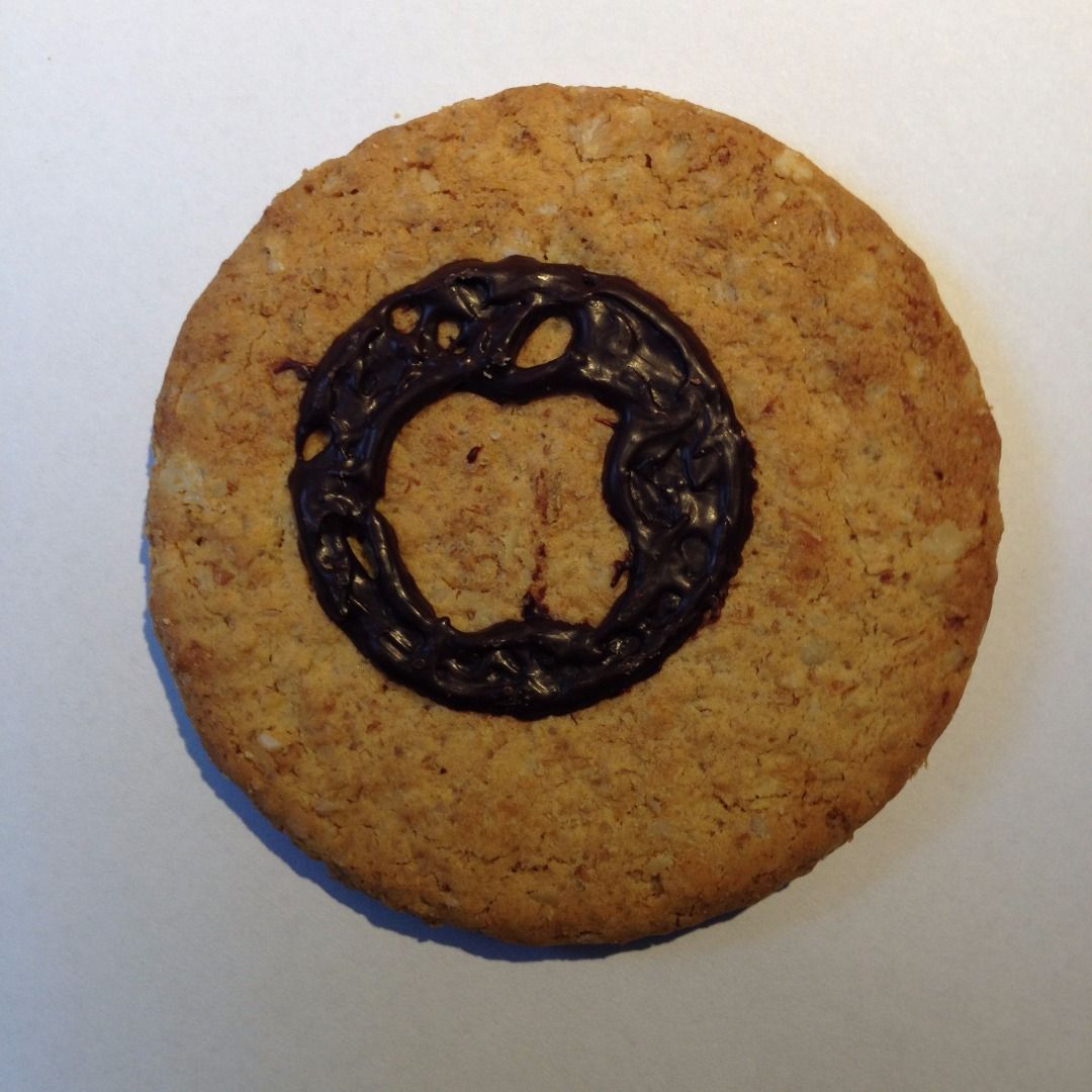

Tips and Tricks
- Don't print objects larger than 20000 mm3.
- Support Structures will become part of the print.
- Don't try to print too much details (picture 3). This print has 12 layers!
- Make sure the first layer isn't too low (Z-axis calibration, picture 4)
- Don't print too fast. The heart in picture 2 went too fast. The chocolate didn't solidify and it cluttered. The upper layers are reasonable. But the start went wrong.
- Avoid large complicated objects. You have 5 to 10 minutes to print.

Finally I started using needles. This way I can print more precisely. See the following logo, printed on a cookie:
