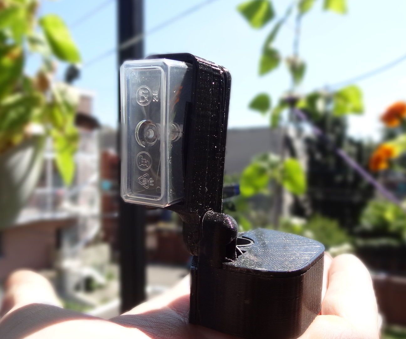

Step 5: Soldering and Check Leds Direction
Aaaah this moment we all love .... Soldering !
Here is a bit tricky but only 3 components ( 2 LEDs, 1 coil).
1) Place the LEDs in the support so that the LEDs are in an opposite direction each other
(when magnet will pass over the coil it will make a positive and negative voltage AC to be said, check the video to better get it )
2) Place the coil as on the picture
3) Solder the LEDs on the coil
4) switch off the solder iron
and you know what ? That's it !
Congrats ! You made it !
N.B : Just check that LEDs work well, one should light when the magnet approaches and the other one when the magnet goes away.
If not you soldered both in the same direction, which is the wrong way.
Congrats ! You're making AC power !
Step 6: Put Everything in the Box and Screw Screw Screw !
As the title and the picture say.
Just put the last assemble in the box with the transparent top red or transparent transparent for the front light.
If you use glue, just don't use acrylic one to seal. It will blur the leds and drastically alffects the brightness
I advise epoxy if required ,normally it works press fit.
Take the largest screw, the "link" part and start screwing all the parts together.
( To be said, I deep fried the light in epoxy to seal it, and was pretty suprised of the finish, did I discover THE way to finish 3D printing ? hmmmm it's smooth but not perfect, would work on flat surface only but it hides very well the famous 3D printed lines).

Step 8: Screw the Magnet on the Wheel
Time to install everything together .... trlrlrlrlrlrlrlrlr ( drum roll) ...
So screw the magnet supports on the wheel as shown on the picture. About middle height of the wheel.
( too high, the magnet will go too fast, no force, no light. Too low, will work ! but not as bright as half placed).
Notice : it must be pretty tight.
Not too much to crack the plastic but clearly enough to stay in position while turning high speed.
If you never experienced the well known "centrigual force" a crash course is gonna be offered to you.
In few words, you'll propulse in the air what you tried to fix on the wheel.
Anecdote : My first try was on my friend's bike ( I was very happy to film my first prototype way far from this model !). This guy just sprinted and in half a second, I could just hear " chbling " (magnet support leaving the wheel) followed by a " wwwwuuuu" (flying in the air)... might still be in orbital around the Earth.
Sir Musk or if you hear about it, please keep me informed. I try as much as possible to recycle the plastic I use.
Thanks by advance ;)
Step 9: Fine Tunning
Last step before the ride.
Slightly adjust the light on the bike frame. I must be very close to the turning magnet installed on the wheel.
it must be as close as possible ( 1 or 2 mm) without touching it. Adjust using the big screw.
And here is why printing at 100 pecent or 5 perimeters infill makes all its sense. you can screw very very very tight and then it won't never crack and neither move !
Lift the bike and give the wheel a spin...
There it goes Induction light is here.
Congrat yourself you did well, very well !
