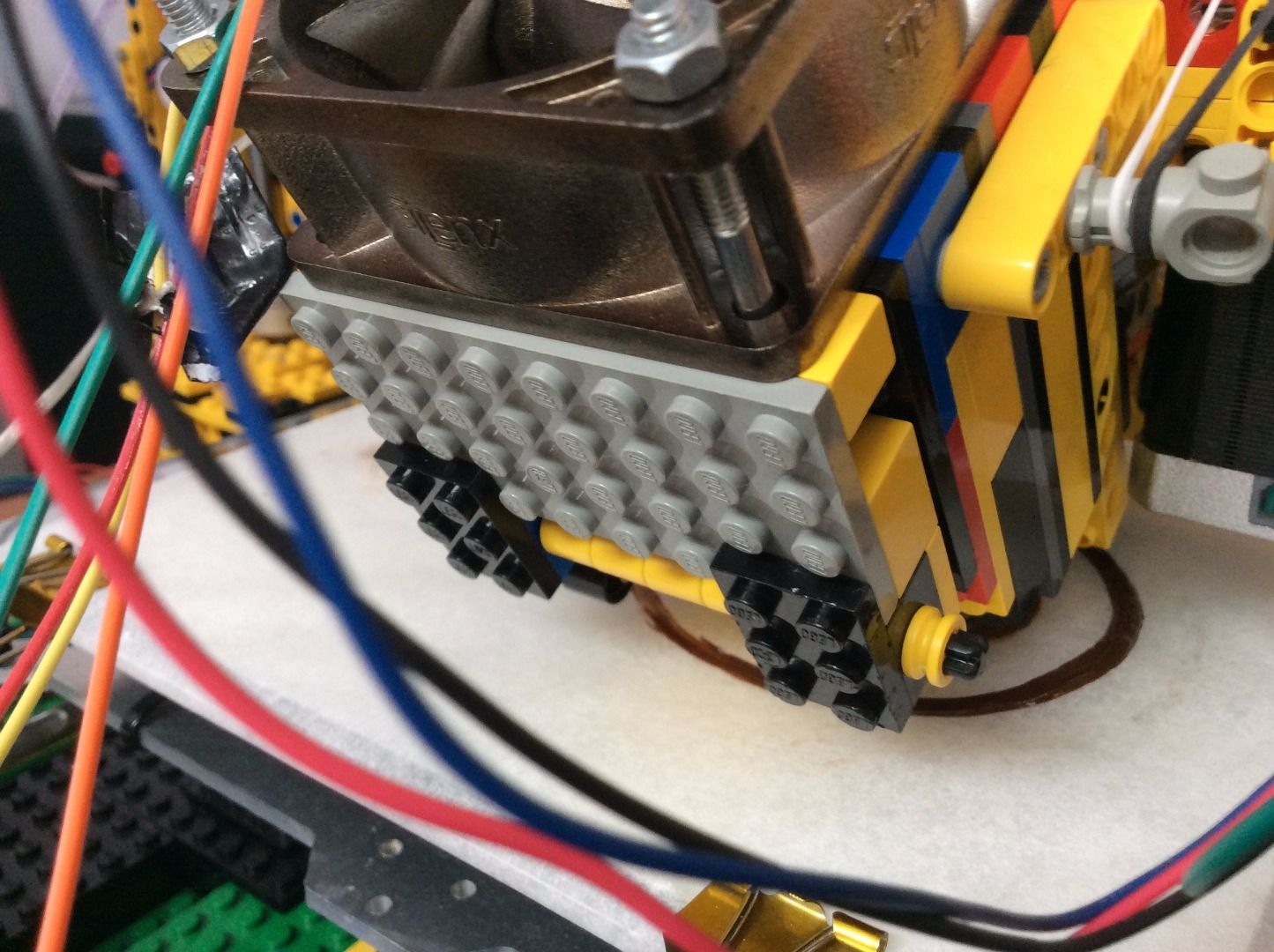

Step 7: Fully Assembled Extrusion Chamber.
again, in theory the lego thermometer and programmable brick should be enough to do the chocolate control, but i used the PID and thermocouple because i was just interested in proving the concept and i had those lying around my lab.

Here's the finished (well, you know, in a rough prototype kind of way) printer.
there are only 3 controllable ports on the rcx brick i used, so one for x, one for y, and one for the extrusion control. you'd need to gang two rcx bricks to further control temperature and the z axis.
I did end up doing 5 layer builds of 3D things like the letter A. unfortunately without a release / support material the geometry is limited, but it was still cool.
