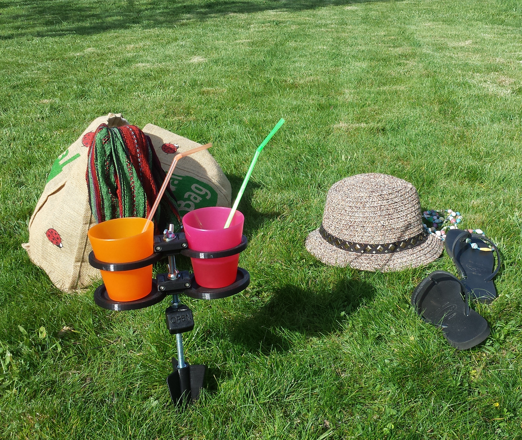

Suitable for soft grounds like the beach but works on a lawn too, prevents the cup holder from spinning. You need two M8 nuts and a washer for assembly.

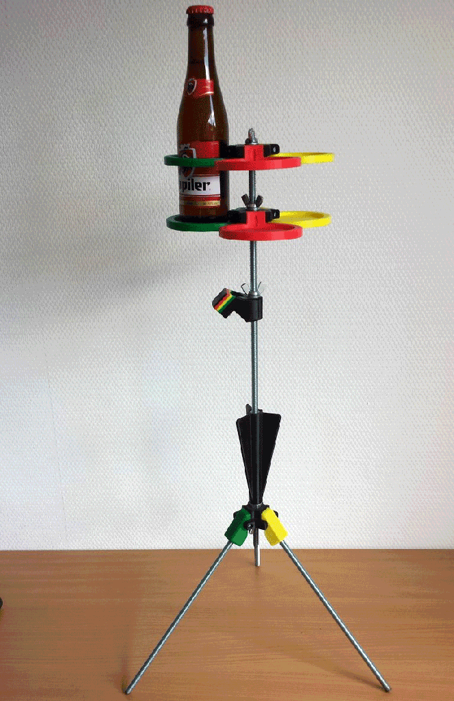

I made the tripod especially because I wanted to use the drink holder on my porch and terras. You will need three of the green pieces together with a single triple joint piece (pink) to assemble the tripod. The legs of the tripod can fold together. I found it a bit disturbing that the legs didn't stay in the correct position while moving the drink holder so I also made a lock ring (yellow) for the legs. You can screw a beach piercer to every leg of the tripod to make your M8-drink holder look extra tough.
  • Bottle opener (orange)
The bottle opener can hold a magnet to guide your unopened bottle in the correct position for popping it's cap of (45°). The magnet also prevents the bottle cap from falling and loosing it (we want to keep the beach clean). You will also need a M8 washer and nut for assembly.

Add a M8 nut to a triple joint piece. Also add a M8 nut to the slots of the tripod pieces. Here the nuts only fit when you slide it in with a corner first. Make sure they align the hole so the legs can be screwed in easily. Insert one or two M3 nuts at the joint sides and screw everything together. Mind that the joint piece is used upside down for the tripod mod (inserted nut up).
  • Bottle opener
Insert a M8 nut for attaching the bottle opener to the threaded rod. Also insert a M8 washer in the dedicated slot under the "open" text. If your washer does not fit you need to heat it up (do not overheat!). If your washer fits too loose you can put some tape around it to make it thicker or find another washer that fits snug. You also have the ability to add a round neodymium magnet (10 mm diameter and 3mm thick) to the bottle opener. Add the magnet to the dedicated slot and push it in the channel. It should be a tight fit.

Congratulations, you should now have a fully assembled M8 drink holder! Here are some pictures of the drink holders I printed. I did some tests in my backyard to evaluate if the design is practical and strong enough. Well, I can tell you that it is!
