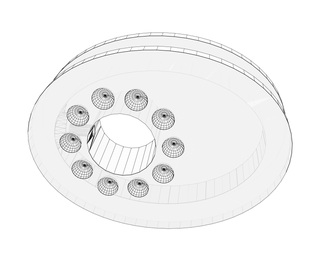

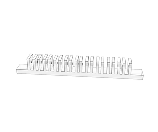

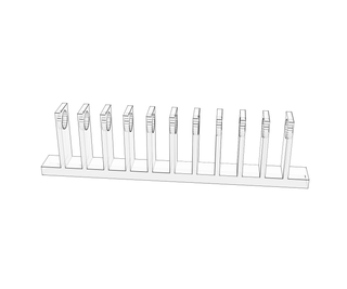

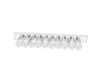

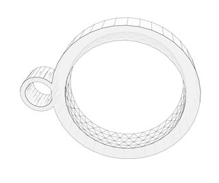

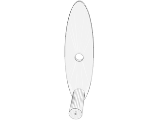

The part list consists of the following:

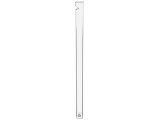

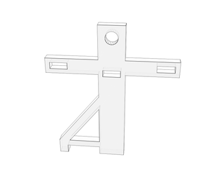

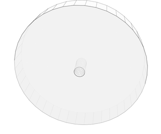

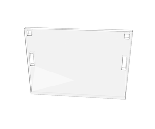

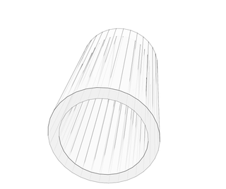

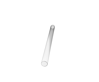

x1 Arm hinge support
x1 Camshaft support
x1 String guide
x1 Main shaft
x1 Base plate
x1 Crank handle
x1 Crank handle sleeve
X1 Crank handle sleeve retainer
x2 Vertical supports
X10 Arms
X10 Camshaft offsets
X10 Ball bearing sleeves
