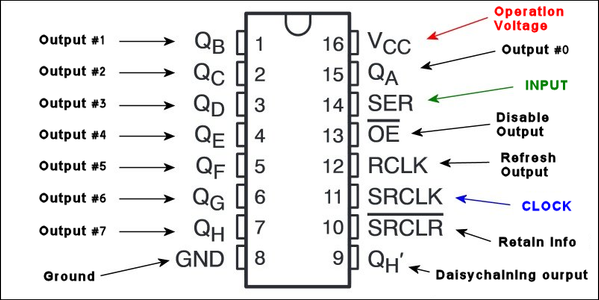

Step 1: Hooking Up the Project in the Breadboard
- Lay out your 4-digit 7-segment display and your ICs on the breadboard. Choose one of the IC chips and label it as '1' and the other as '2'. It will be important as the chip '1' controls the seven segments of each digit while chip '2' controls the four digits.
- Connect pin 16 and pin 8 (as labelled from the diagram) of both chips to positive (VCC) and negative (GND) rails of the breadboard. (NOTE: Remember to use the "notch" on top of the chip as a way to identify the pins).
- Connect 1k resistors to pin 15 and pins 1 - 7 (i.e Qa - Qh)on chip 1.
- Connect the resistors from pins 15, 1,2,3,4,5,6 and 7 of chip 1 to pin A,B,C,D,E,F,G and 'DP' of the 4-digit 7-segment display (Check diagram of the digits display). So, pin 15 resistor would be connected to pin A, pin 1 resistor to pin B, pin 2 resistor to pin C, pin 3 resistor to pin D, pin 4 resistor to pin E, pin 5 resistor to pin F, pin 6 resistor to pin G and pin 7 resistor to pin 'DP'.
- Now, connect pin 15, pin 1, pin 2 and pin 3 of chip '2' to the pin D1, D2, D3 and D4 of the display respectively. NOTE: Chip 2 does not need resistors.
- Now, connect pin 9 of chip '1' to pin 14 of chip '2'. Pin 9 of chip 2 will be unconnected.
- Connect pin 12 of chip '1' to pin 12 of chip '2'. Then, connect from pin 12 of chip '2' to pin 3 of Arduino Uno.
- Connect pin 11 of chip '1' to pin 11 of chip '2'. Then, connect from pin 11 of chip '2' to pin 2 of Arduino Uno.
- Connect pin 10 of both chip '1' and chip '2' to VCC.
- Connect pin 13 of both chip '1' and chip '2' to GND.
- Finally, connect pin 14 of chip '1' to pin 4 of Arduino Uno.
Now, for closing part of this step, connect the VCC and GND rails to 5V and GND pins of Arduino Uno repsectively.
