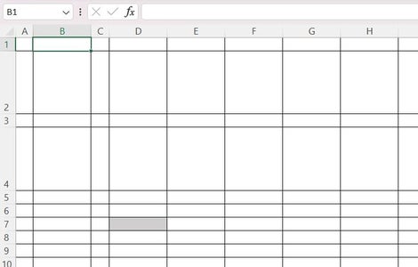

Step 1: Resizing Cells
Make narrow columns A and C.
Make higher files 2 and 4.
As shown in the image.
Do you see the intention of these? Can you imagine now where the number is to be shown?
