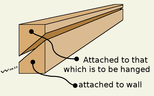

I think French Cleats are pretty cool, But I don't have the tools to make them.
I decided to take a small piece of wood and connect it to the board with a small 90° shelf bracket.
