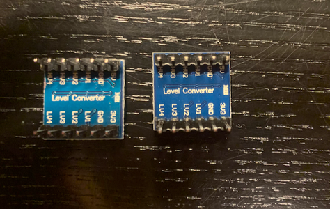

- A voltage level converter.

PS2 keyboards need 5V. To make 5V available on the board you need to shortcut a connection on the back side of the Arduino as it is shown in the picture. Solder this connection. Now the 5V pin of the Arduino has power. Connecting it with any other pin will probably damage the board.
You will need the level converter now. Connect 3.3V, GND as well as the Arduino pins 2 and 5 to the 3.3V side of the level converter. Connect 5V and GND to the 5V side of the level converter. I placed the level converter and all the other 5 V stuff on the lower side of the board to avoid any accidents.
Now you can connect the PS2 socket like it is shown in the drawing. The clock pin on the right side of the socket goes to the pin of the level connectors 5 V side that has the pin 2 data of the Arduino. The data pin is connected with the level connector pin that has the pin 5 data of the Arduino. Power and ground are connected respectively.
