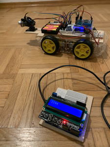

Introduction: Build a Robot Car With an 80s Style Home Computer As Controller.
About: Loves to play with things - 70s retro computing and microcontrollers is my interest at the moment.
On almost all electronics web shopping sites there are kits for two wheeled or four wheeled robots. The content of these kits are pretty much the same. Motors and wheels, a motor controller based on the LM298 chip and an Arduino UNO. They also come with a few sensors. The ultrasonic distance sensor is always included. Some have a remote control and a few other components. The frame is of transparent plexiglas. I bought mine at Banggood a while ago. When I started to assemble it, I found that this kit cannot be used to build a robot without additional components. You need to add things and build something individual. This Instructable is about my attempt to do so.
I wanted the car to be self driving and do autonomous things. I also wanted to use my IoTBASIC interpreter on it and control the activity of the car with a BASIC program. With this interpreter language, I can log on the robot, modify the program and restart it without needed the Arduino IDE or any other development system. Essentially this is as if an 80s style home computer would be put on wheels.

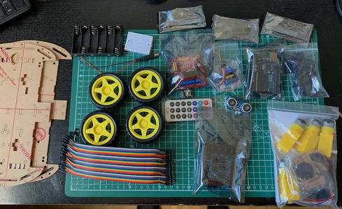

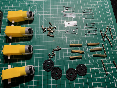

To build this robot, you first of all need the robot kit. I used a four wheel kit. They can be bought practically everywhere.
Additional components usually not in the kit are
  • An Arduino R4 Minima, R4 Wifi or ESP32 Wemos R1 board.
  • The Arduino Motor Shield R3.
  • A HC05 Bluetooth to serial controller to log on to the robot remotely.
  • A 32kB EEPROM chip (optional).
  • Some plywood boards, rubber bands and other little things found in most workshops.

Step 1: Build the Car Chassis

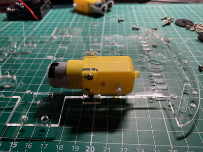

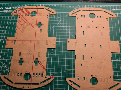

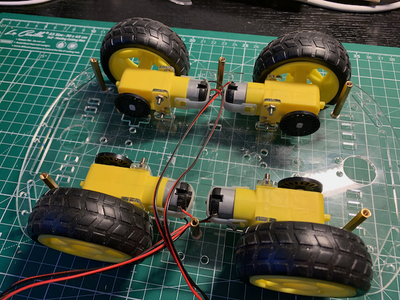

The base car can be build pretty easily. Remove the protective foil from the plexiglas base plates. They are identical but they have a front and a rear which is different. Some people leave the foil on the plates but I found that it looks odd. In my kit I had to solder the wires to the motors. Then mount the yellow motor holders to the lower plate and insert the motors. After that the wheels can be inserted.
I then soldered the wires of the two motors together on the right and left side. Both left side motors are later connected to channel A of the motor controllers. The right side motors go to channel B.
If you build the car with the Arduino Motor Shield you can now add the top plate. All this is pretty straight forward and all the components in my kit did fit together well.
The top part of the kit was a little harder to build.
If you want use the standard motor electronics coming with the kit, there is some more later on.

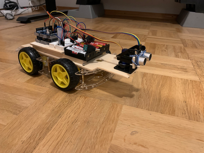

Step 2: Build the Upper Part of the Robot.
The upper part of the robot is meant to have the ultrasonic distance sensor. There is a servo together with some plastic parts which could serve as a mount for the sensors. With this the robot can look around and measure the distance to obstacles in different directions.
These parts however did not fit together at all in the kit hat I had bought. The holes in the plexiglas to plate did not fit and the mount for the sensor also did not fit. The servo could not be inserted properly into the holder plate that came with it. Obviously someone had thrown together some parts that were never meant to fit together.

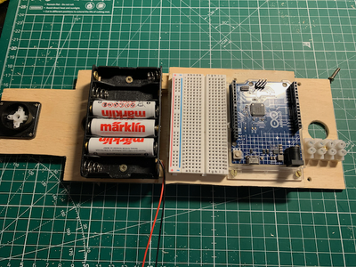

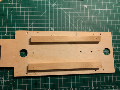

To build the robot I decided to mount the active components on a plywood plate that I would mount on to of the plexiglas plates coming with the kit. Plywood is pretty elastic. It can absorb friction much better than plexiglas which can develop fissures if strong forces are applied to it. The plywood hat would stabilise the car and components can be mounted easily on it. Cutting, drilling and gluing plywood pieces can be done with simple tools.
As a basis I use a 23 cm long plywood plate with a 6 cm nose at the front.Holes were drilled exactly at the points where the upper part of the car is screwed to the lower part. This way you only need one set of screws to put everything together. Also, cut out two circles for the motor cables.
On top of this base plate I add two wooden strips that a glued on the base plate and fixed with small screws from below. On the wood strips comes the battery pack close to the front wheels.
The Arduino with it's Motor Shield on top and a small breadboard are mounted on a small plywood plate. I usually glue the base of the Arduino and the breadboard to the wood with two sided adessive stickers or tape. I removed one of the power lines of the breadboard to make it a little narrower. With this modification the three components fit exactly between the two holes for the engine cables.
Mounting the Arduino and the breadboard on the second plywood plate makes it easy to remove it later and replace it with other components. Simple short metal screws can be used to hold the Arduino and the battery pack on the wood strips.

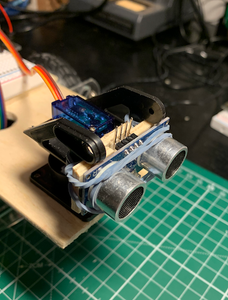

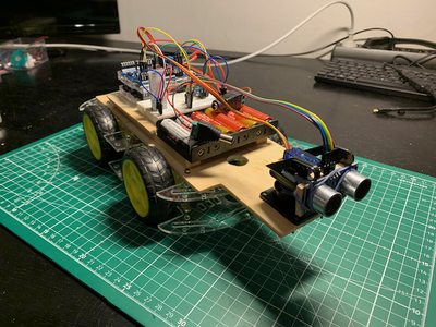

Lastly, the holder plate for the servo is screwed to the nose. The arms of the sensor didn't fit into it in my kit. I cut the arms to the right side and then screwed it to the holder plate.
At the rear of the base plate you can see a set of lustre terminals screwed from the bottom on the wood plate close to the hole for the engine cables. Putting the engine cables through the hole and then attaching it to the lustre terminals helps to keep the cabling clean on the top later on.
The holder for the sensor also didn't really fit in my kit. I improvised with plywood pieces and a rubber band to fix it in my first build.
With all this done, the upper part of the robot can be fixed and we can add the electronics.

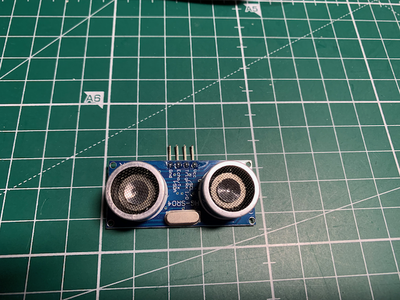

Step 7: Add an Ultrasonic Sensor
To use the sensor cable the trigger pin of the sensor to pin 4 of the Arduino and the echo pin to pin 5. Connect power to the sensor.

Run this program once with RUN. If the sensor is connected and working properly, the program will output the distance of the next object in front of the sensor in milli meters.
The PULSE command in line 40 sends a pulse of 10 time 10 microseconds to pin 4. The PULSE function in line 50 is the well known pulseIn() of the Arduino IDE. It measures the pulse length on pin 5, raising flank with a timeout of 100 times 10 microseconds.
The program runs in an infinite loop. Sending the character # will end the loop and the input prompt returns.
 A word on the units here. Unlike in the Arduino IDE, BASIC uses 10 microseconds as the smallest unit of the PULSE command. This is because the interpreter runs slower than C programs and processes one command per 4 microseconds on many platforms. For use cases that require faster reaction times, BASIC is probably not the right language. The base unit of PULSE is a parameter that can be set at runtime with the SET command. Please look at the manual for more on this.

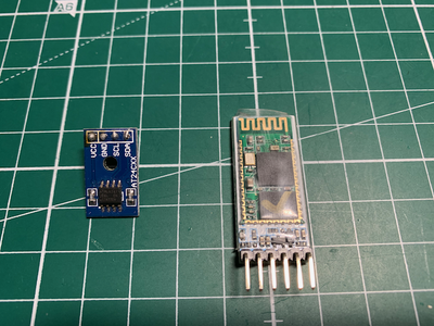

Step 9: Remote Control With the HC05 Bluetooth Module
So far the whole system is still attached to the USB connector of the computer. To make it a little more independent, we need some radio connectivity. The easiest and cheapest way of doing it is a classical Bluetooth connection.
There are many excellent tutorials on the HC05. Please look at them how to pair your computer and set them up. I recommend
This work uses SoftwareSerial and pins 10 and 11 to connect the module. We do not need that here and connect the module directly to the UART of the Arduino.

As BASIC programs for the robot become bigger, the internal EEPROM of the Arduino might not be enough. Also, the internal EEPROM can only hold one program at a time. To store multiple programs on the Arduino, an external mass storage is needed.
BASIC supports multiple options for this. For a robot, an external EEPROM is the best option. It can be plugged in and out, even while the robot is powered on and can store BASIC programs and data. I use 32kB EEPROM modules. They are cheap, available everywhere and can be used with an I2C connection. This keeps hardware complexity at a minimum.
Put the module on the breadboard and connected it to power, ground and the two I2C signals SDA and SCL.
To integrate the mass storage, an additional setting in the firmware is needed. Connect your robot to the computer, open the Arduino IDE and look for the ARDUINOEFS macro. Set
 #define ARDUINOEFS
EEPROM modules have I2C addresses between 0x50 and 0x57. Default in BASIC is 0x50. If your EEPROM has a different address, look for the macro EFSEEPROMADDR and set the address correctly.
Once you have compiled and uploaded the firmware, go to the BASIC command line prompt.
The FDISK command formats the internal disk. It requires one argument. This is the number of slots the EEPROM is divided into. EFS is a very simply file storage. It has fixed length slots. Formating a 32kB EEPROM with
FDISK 4
 would create 4 slots of 8 kB for programs. Saving and loading a program is done with the SAVE and LOAD command with a file name argument. File names can be 12 characters long.
Programs stored in the internal EEPROM can still be accessed with the commands LOAD "!" and SAVE "!".

Step 14: Add an MQTT Remote Control
Now that the turtle understands MQTT messages, it is quite easy to add a remote control.
I use and Arduino R4 Wifi for it. The R4 Wifi is a 5V board and compatible with the standard LCD Shield. Alternatively a Wemos D1 8266 board can also be used for this. They are cheaper than the R4 Wifi and compatible with the LCD library. I could not get the ESP32 board to run with the LCD shield. Like all the Arduino lookalike shield, there are pinout / pin use conflicts.
The hardware settings for the BASIC interpreter need to be
#define DISPLAYCANSCROLL
#define LCDSHIELD
#define ARDUINOEEPROM
#define ARDUINOMQTT
all other definitions have to be #undef in hardware.h.
Mount the LCD Shield on the board. Compile and upload the BASIC interpreter on the Arduino Wifi.
Then upload or type in the BASIC program
10 OPEN &9,"littlerobot/data"
20 OPEN &9,"littlerobot/command",1
30 S=0
40 WHILE -1
50 GET &2,C
60 SWITCH C
70 CASE "1": PRINT &9,"l"
80 CASE "2": PRINT &9,"r"
90 CASE "3": PRINT &9,"b"
100 CASE "4": PRINT &9,"f"
110 SWEND
120 IF AVAIL(9)=0 THEN CONT
130 INPUT &9,A$: IF A$<>"" THEN CLS: PRINT &2,INT(VAL(A$))
140 WEND
Program download link: remote.bas
SAVE and RUN it. Pressing the buttons on the shield will send the turtle commands f, b, r, l to the MQTT topic littlerobot/command and display the answer from the topic littlerobot/data.
If you now run the MQTT turtle program on your robot, you can see it move.
