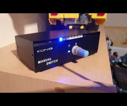

Step 5: Flawless Integration
You can check in the attached video that the FSM solution works accurately and fast even in case of low range rotary encoders with various sporadic bounce effects.
