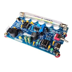

Step 1: The ESP32
The sensor or data does not matter. I used a $60 Geiger counter because I wanted my setup to collect data for very long periods of time, like weeks or months, so I opted for background radiation particles. I believe this project would be just as neat with a $2 ambient light sensor.
The ESP32 Nano is a powerful microcontroller that supports Wi-Fi, making it a great tool for IoT/wireless projects.
