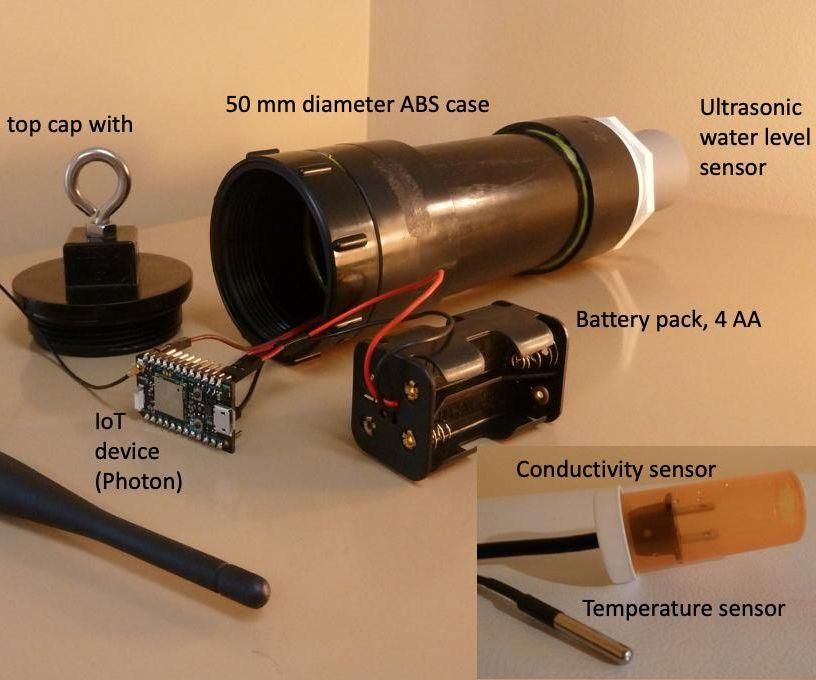

Step 1: Assemble the Meter Case
Assemble the meter case as shown in Figures 1 and 2 above. The total length of the assembled meter, tip to tip including the sensor and eye bolt, is approximately 320 mm. The 50 mm diameter ABS pipe used to make the meter case should be cut to approximately 125 mm in length. This allows sufficient space inside the case to house the IoT device, battery pack, and a 170 mm-long internal antenna.
Seal all joints with either silicon or ABS glue to make the case watertight. This is very important, otherwise moisture can get inside the case and destroy the internal components. A small desiccant pack can be placed inside the case to absorb moisture.
Install an eye bolt in the top cap by drilling a hole and inserting the eye bolt and nut. A nut should be used on both the inside and the outside of the case to secure the eye bolt. Silicon the inside of the cap at the bolt hole to make it watertight.

Step 3: Attach Sensor, Battery Pack, and Antenna to IoT Device
Attach the sensor, battery pack, and antenna to the Photon (Figure 4), and insert all parts into the meter case. A list of the pin connections indicated in Figure 4 is provided below. The sensor and battery pack wires can be attached by soldering directly to the Photon or with push-on-type connectors that attach to the header pins on the underside of the Photon (as seen in Figure 2). Using push-on connectors makes it easier to disassemble the meter or replace the Photon if it fails. The antenna connection on the Photon requires a u.FL type connector (Figure 4) and needs to be very firmly pushed onto the Photon to make the connection. Do not install the batteries into the battery pack until the meter is ready to be tested or installed in a well. There is no on/off switch included in this design, so the meter is turned on and off by installing and removing the batteries.
List of pin connections on the IoT device (Particle Photon):
Photon pin D3 - connect to - Sensor pin 2, data (brown wire)
Photon pin D2 - connect to - Sensor pin 6, V+ (red wire)
Photon pin GND - connect to - Sensor pin 7, GND (black wire)
Photon pin VIN - connect to - Battery pack, V+ (red wire)
Photon pin GND - connect to - Battery pack, GND (black wire)
Photon u.FL pin - connect to - Antenna
