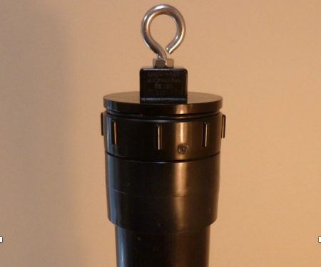

Step 1: Assemble the Meter Case
Assemble the meter case as shown in Figures 1 and 2 above. The total length of the assembled meter, tip to tip including the sensor and eye bolt, is approximately 320 mm. The 50 mm diameter ABS pipe used to make the meter case should be cut to approximately 125 mm in length. This allows sufficient space inside the case to house the IoT device, battery pack, and a 170 mm-long internal antenna.
Seal all joints with either silicon or ABS glue to make the case watertight. This is very important, otherwise moisture can get inside the case and destroy the internal components. A small desiccant pack can be placed inside the case to absorb moisture.
Install an eye bolt in the top cap by drilling a hole and inserting the eye bolt and nut. A nut should be used on both the inside and the outside of the case to secure the eye bolt. Silicon the inside of the cap at the bolt hole to make it watertight.
