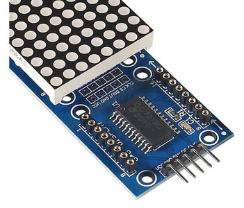

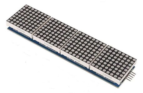

Step 1: Connecting the Displays
Connecting two of these boards together can be a challenge. Each individual board has a 5 pin header on the input end and 5 empty pads on the output end. The difficulty is that the header pins on the input end are not mounted to mate directly with the output pads at the other end. Here are some possibilities. The second board needs to have the header pins carefully removed, so as to not damage the pads, and then a new 5 pin header mounted which points outward from the back of the board. The first board gets another 5 pin header soldered into the empty 5 pads at its output end. The two boards can then be electrically joined by mounting 5 jumper straps between these pins.  Simple wire jumpers soldered between the 5 sets of pads could also be used. Another possibility is to bend downward, in a U shape, the pins on the second board and then fit them into the solder pads on the first board. The two boards are then assembled on a 3D printed plastic mount with #4 machine screws.
Step 2: The Hardware
The LED boards have an SPI interface and the LedControl library is the driver used. LedControl is an Arduino library for the MAX7219 and MAX7221 LED display drivers. The code also works nicely with an ESP32 microcontroller. Documentation for the library is on the Github Project Pages http://wayoda.github.io/LedControl/ The latest binary version of the library is always available from the LedControl Release Page (https://github.com/wayoda/LedControl/releases). The library can be installed using the standard Arduino library install procedure found at http://arduino.cc/en/Guide/Libraries#.UwxndHX5PtY/.
The ESP32 microcontroller was chosen for its Internet connectivity and SPI interface. I selected a 38 pin version of the ESP32 and designed and produced a general purpose printed circuit board (PCB) using the free ExpressPCB software. This PCB will accommodate a 38 pin ESP32 with either 0.9 or 1.0 inch wide pin spacing. The PCB mounts the ESP32, and connections for a DS3231 Real Time Clock (RTC) in two different pin formats, a BME280 Temperature and Humidity module, an optional PAM8403 Audio Amplifier module and an optional LCD display. A word of caution on the BME280 Temperature and Humidity module is in order. Many of the BME280 units available on both Amazon and eBay do not have the humidity interface functioning, only the temperature. I suspect these are production culls, so be aware if you need the local humidity reading. I placed a trap in my code to catch this if the local humidity value returns a zero value. Additional pads running to the ESP32 have been added to the PCB. This allows the addition of other components, for example a RCWL-0516 microwave sensor used as a motion detector.
