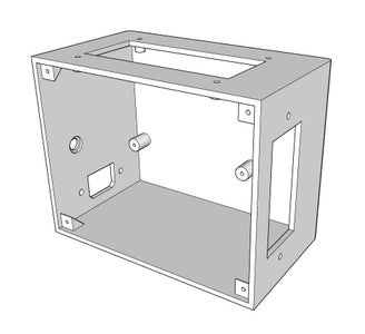

I designed a printed circuit board using the free ExpressPCB software and ordered three of their mini boards of the design. The layout for this PC board is shown in the images. With the many connections this greatly simplifies construction. A project box was designed in SketchUp and then 3D printed. The SketchUp files can be downloaded below. This also makes for easy construction as the printed box has all the right size cutouts in place. If you buy or build your own project box make sure to make it large enough to easily accommodate everything since there are a number of wire connections needed inside the box besides the PC board.
