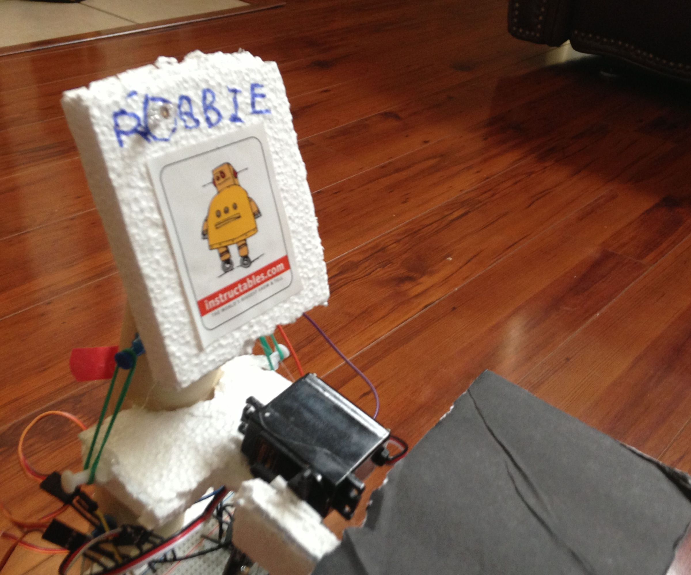

Introduction: AAA Robot (Autonomous Analog Arduino)
The AAA Robot is a perfect robot for beginners. It is versatile, easy to build, and discusses many of the topics roboticists need to learn, including but no limited to transistor switches, motor driving nad analog sensors. This Instructable includes step-by-step instructions on how to build your very own robot.
This robot has two modes, manual and automatic. In manual mode, one pair of sensors is compared on the left and right side of the robot and the code (attached in file) will compare the two readings and steer the robot towards the stronger reading. The automatic mode pretty much does the same, except you can switch between three sensors, using one at a time.
