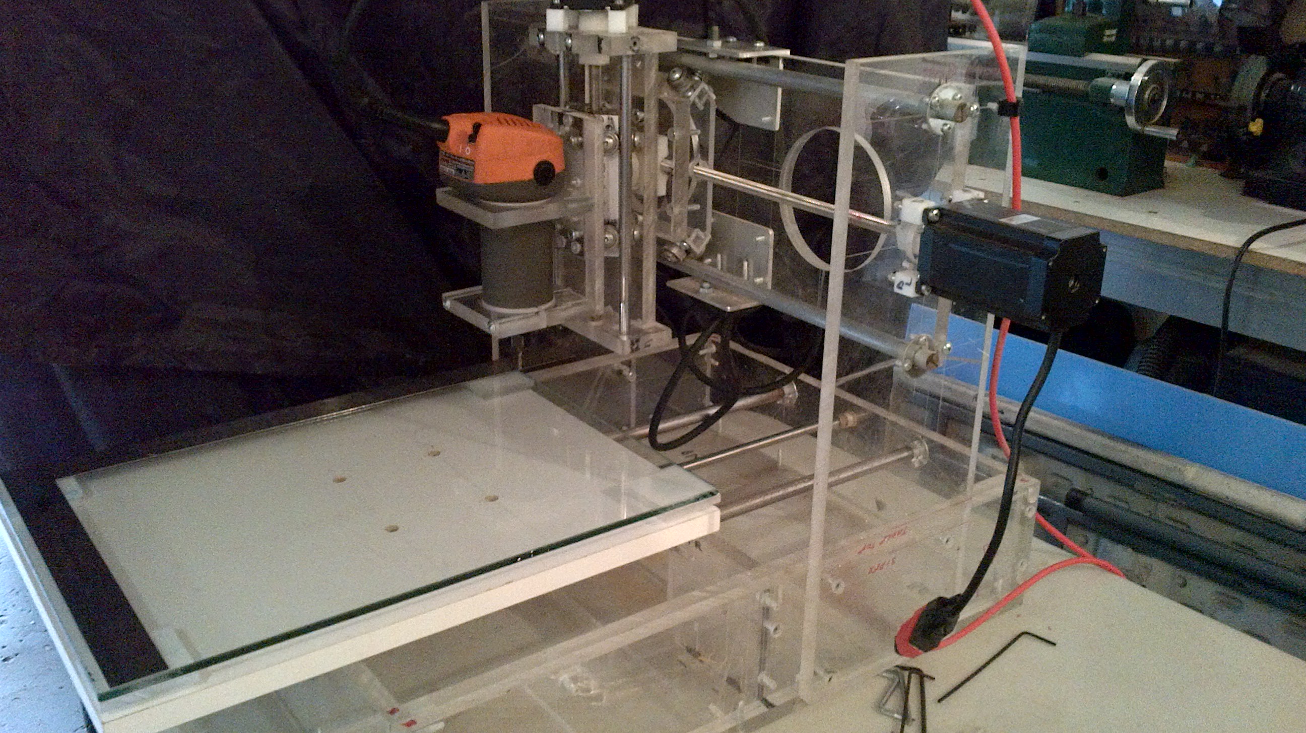

A water feature being out of my price range and always looking for an excuse to use my home built cnc I came up with this garden decorating idea.

I had some 24 gage aluminum kicking around so that became the choice of material.I fastened the aluminum to the spoiler board with double sided carpet tape and secured the perimeter with masking tape to make sure it stayed put.I haven't cut aluminum on my cnc till this point so wasn't sure what to expect.The only router bit I had kicking around that might do the job was a 2 flute carbide upcut bit.It seemed to work but I am looking forward to trying some Onsrud bits in the future.The #65-023 looks like a good general purpose bit for aluminum,plastics and wood.
