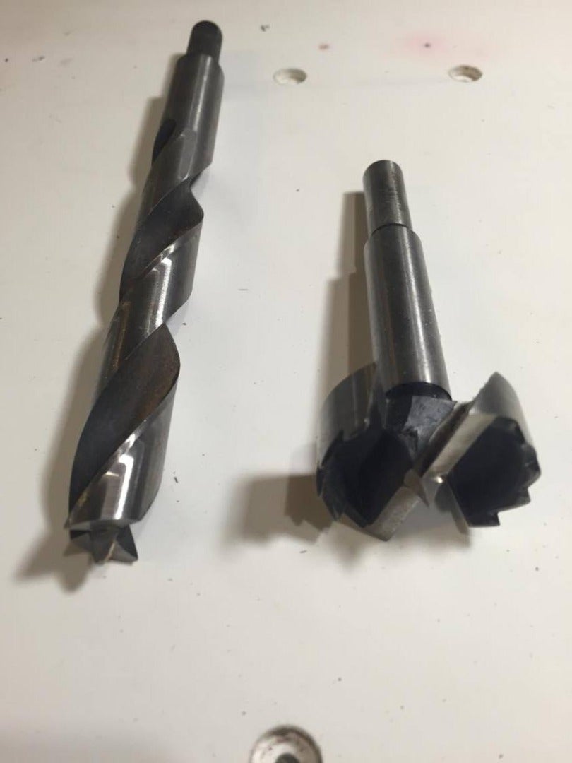

These are some of the sizeable pieces they consider scrap The owner of the company only gets 3 cents a pound so go to a plastic fabricator and make an offer. The black material is the UHMW and is what we will be making the bearing blocks out of.All of the holes will be created using forstner or brad point bits as they are more precise and easier to align holes. In the case of the bearing hole where you only want to drill to partial depth the bit will leave a mark where to continue through with the smaller clearance hole.

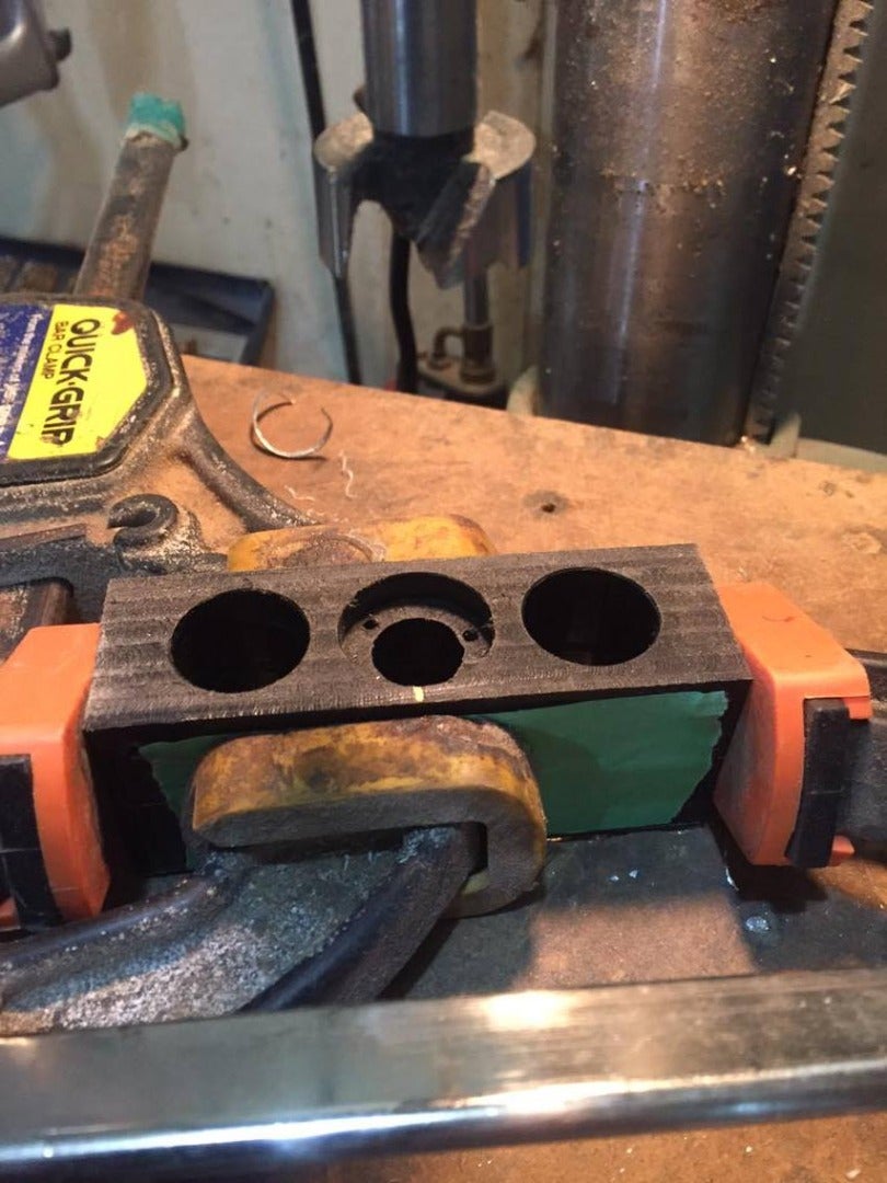

Stack pieces and clamp
drill outer holes right through with 22mm forstener bit
With them still clamped drill a 1” hole 1/8”down now use a 5/8” bit and drill right through
first layer and with a 5/16” bit continue down through bottom layer.
Drilling in this fashion helps keep your centers more accurate.Drilling in this order with a brad point or forstener bit leaves a center mark where you can proceed with the smaller drill size.

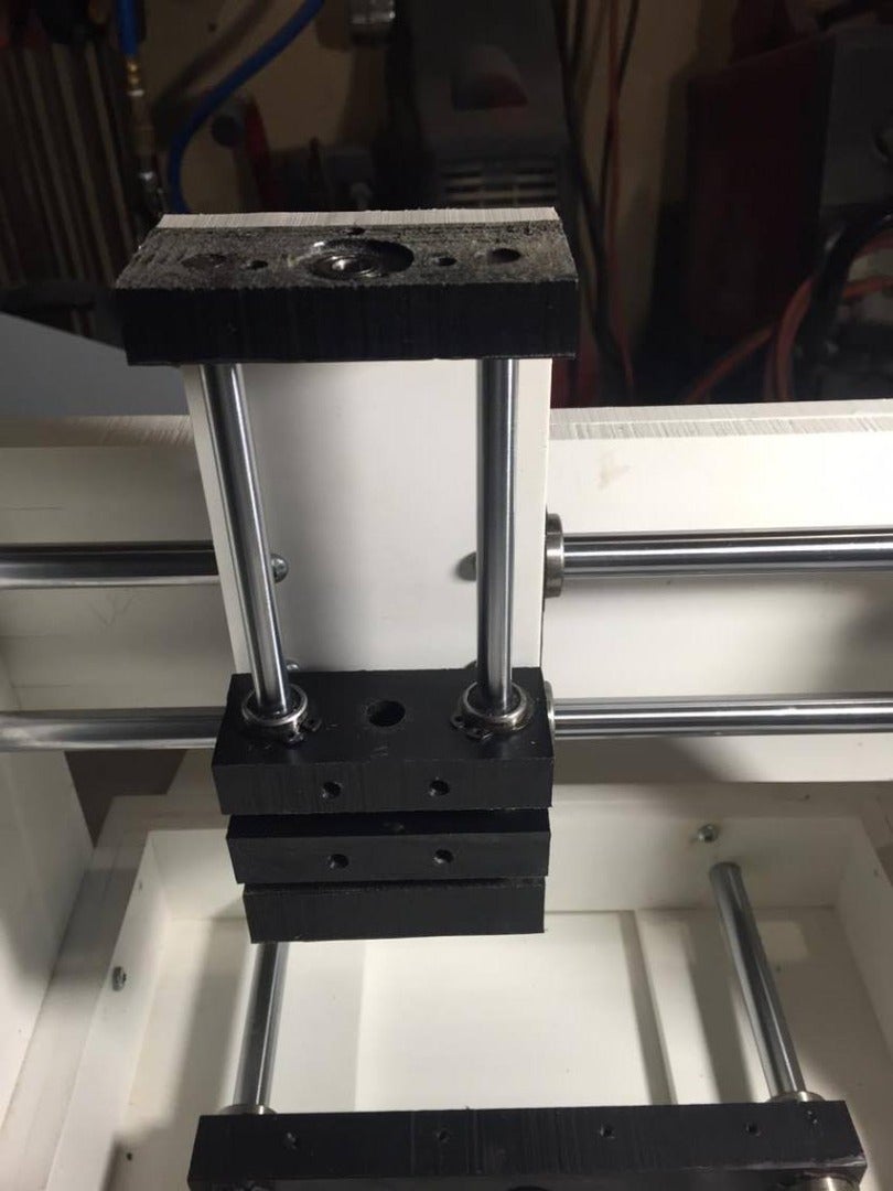

Step 3: ​Z-axis Bearing Blocks
Cut 4 pieces 3” x 1 ¼” x 5/8”
Stack and clamp 2 pieces and drill outer holes with a 15 mm bit through both layers
Drill 1” hole 1/8” deep,drill 5/8” hole through first layer and continue through bottom layer with 5/16” hole.
Set aside other 2 blocks for now.

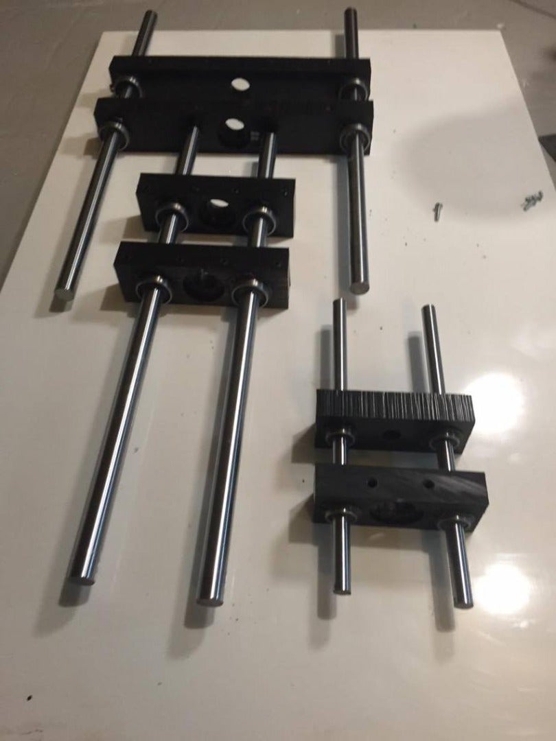

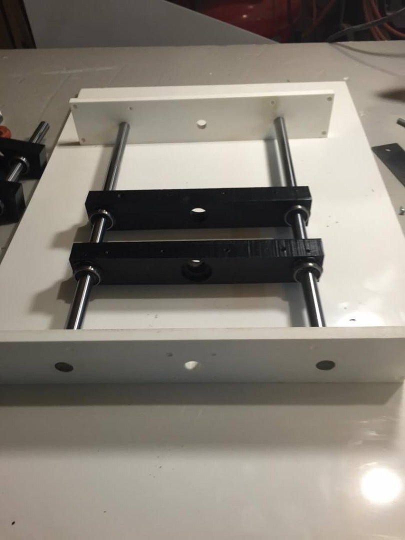

Assembling blocks bearings and rods :
Cut 4- 12mm rods to 13”
Cut 2- 8mm rods to 6 1/8”

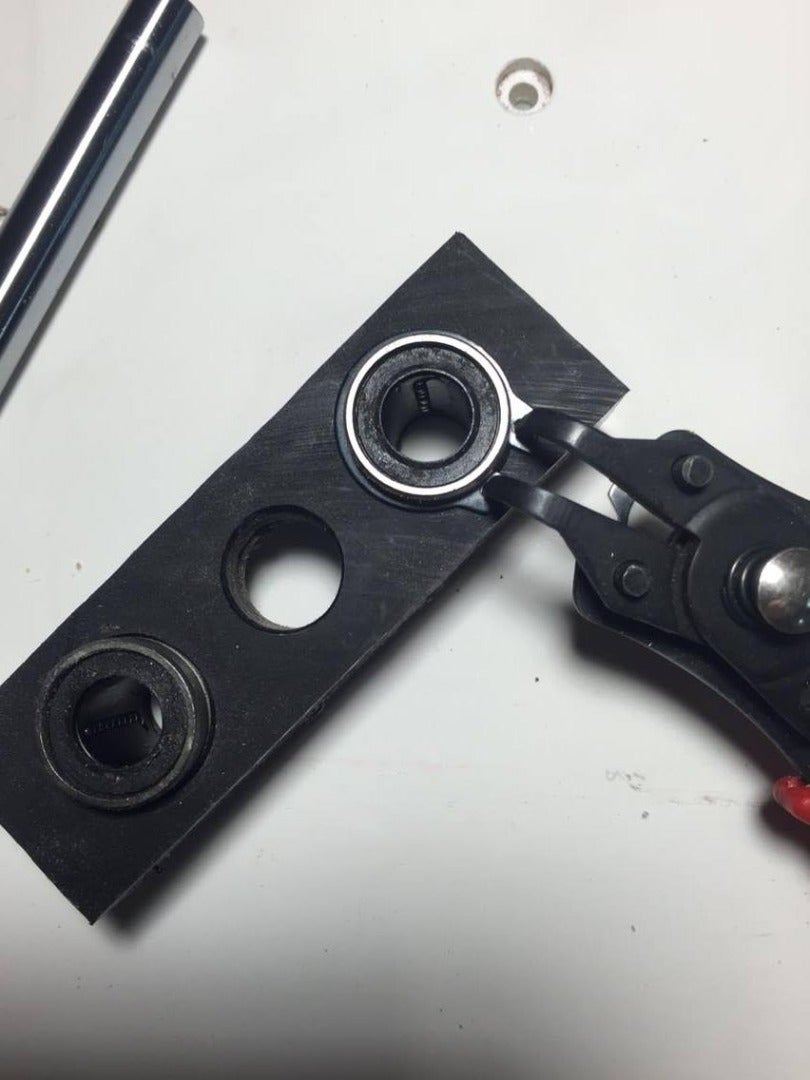

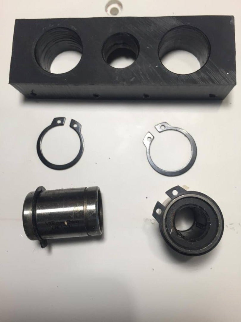

Bevel rod ends slightly to avoid damaging rubber seals on bearings.Now put external snap ring in one groove of each bearing and push through corresponding holes until groove is exposed on other side and then attach other snap ring.
I used one of those assorted packs you can buy, it was imperial but found 7/8” fit the 22mm o.d. bearings and the 5/8”worked on the 15mm o.d. bearings.Snap ring pliers would probably be a good idea as they are pretty cheap.Keep the 1” drilled piece to the outside as shown.

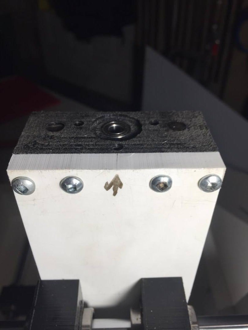

Assemble pieces as shown in picture keeping 3/16” holes to top. Take 3/16” brad point bit drill through front and back pieces just enough to mark centers on sides and then take 1/8” brad point bit and continue to drill to a depth of an 1”.Assemble with 1” number 8 screws.
Drilling and assembling outside perimeter base :

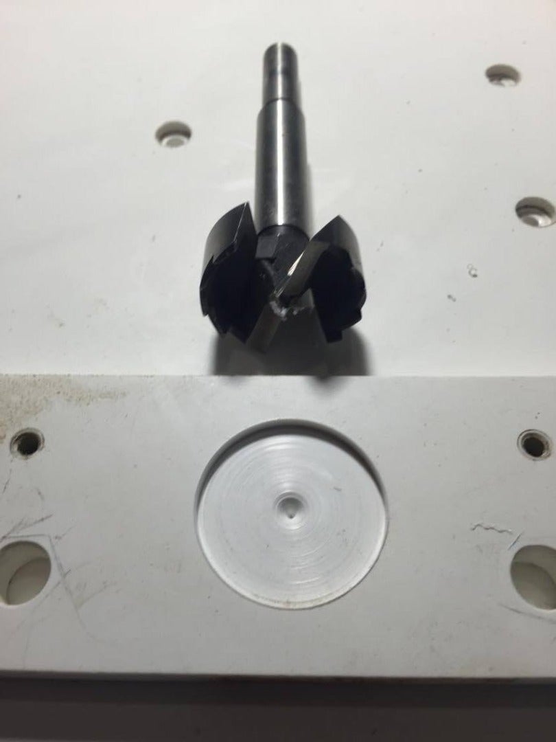

Take one 12 ¼” piece and drill ½” hole where indicated to a depth of 7/32”
take other 12 ¼ “ and drill to a depth of 7/32” as well till the ½’ bearing fits is just below the surface.
Now you can stack the front and back and drill through with 3/16” where indicated.And finally drill through with 3/8” to center of ½” hole.Drill 1/8” holes to a depth of ¼”.
Turn over and fit in base drill 1/8” clearance holes and fasten with 5/8” #8 screws.

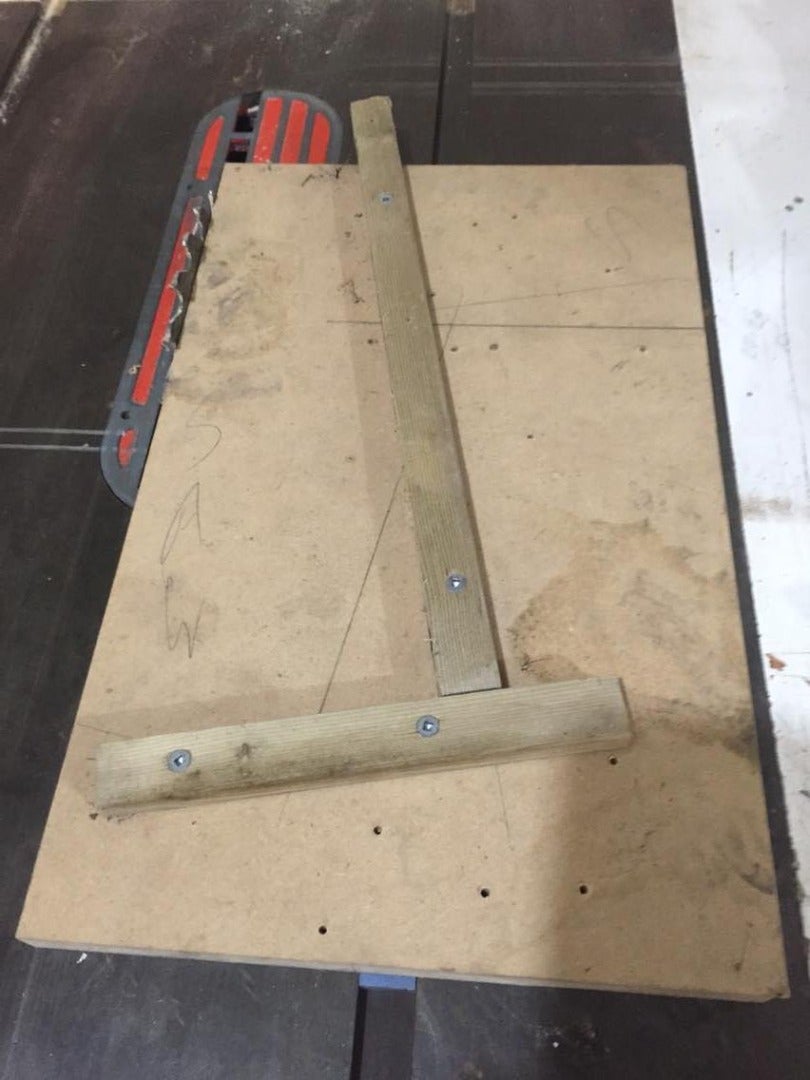

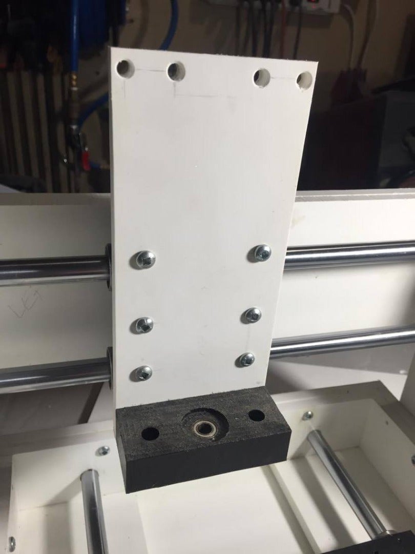

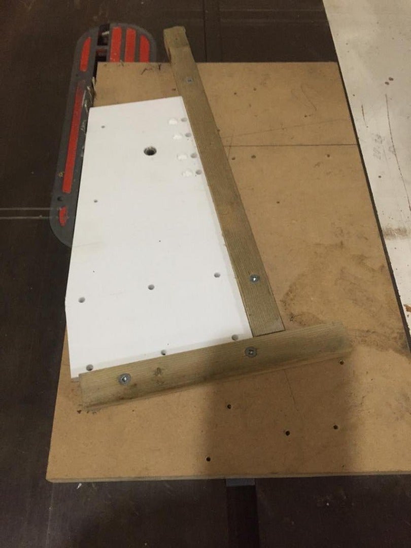

Stack and drill 4 pieces keeping left and right pieces aligned and drill 9 -3/16” holes through all pieces excluding 2 on angle.Here is a simple jig I made for cutting angles.You just attach a strip of wood that fits into your mitre guage slot on to the back of some scrap wood large enough to accommodate your side piece and run it through table saw.Then lay your side piece with angle locations lined up with the edge of the board and screw down some wood slats to hold it in place.Run all 4 pieces through to perfection.
Now you can stack and drill 2-3/16” holes on exterior pieces on angle.
Almost forgot drill 4- 1/16” motor mount holes in right side outer upright.
Cut 2 braces to sizes indicated.Drill the 3/16” holes right through the large piece And the 1/16” holes to a depth of about ¼’on smaller piece. Keep one inch hole to left.Use 1”#8 to assemble. If you used panheads drill indents for clearance.Again use 1”#8 screws for end holes use Use 5/8”#8 for 2 holes on angle and 8 holes on brace.
Step 7: ​Z-plate Cut Drill and Assembly
Cut and drill Z backplate to required dimensions countersinking lower 3 holes.
Cut and drill Z top plate ½” inch center hole to a depth of 7/32” and then continue through with a 3/8” hole.
Drill 8mm holes all the way through.Do the same to the center hole of the bottom plate but drill 8mm holes to a depth of 5/16”.Assemble as shown.

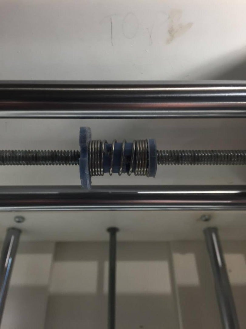

Take the large piece of the antibacklash nut put on the spring and put on the small piece.Compress the spring slightly as you thread the rod through now attach 1” diameter end to rear bearing block with ½”#6 screws.
Now as far as I know anti backlash nuts are only available for tr8 acme threaded rods the ones pictured that I am using I have made with my cnc machine and will be on my website in the near future,just have to get a few bugs worked out.With the backlash nuts fastened press the ½”bearings into a all axis locations.

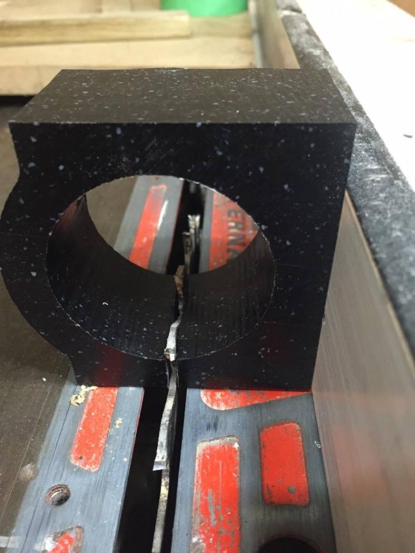

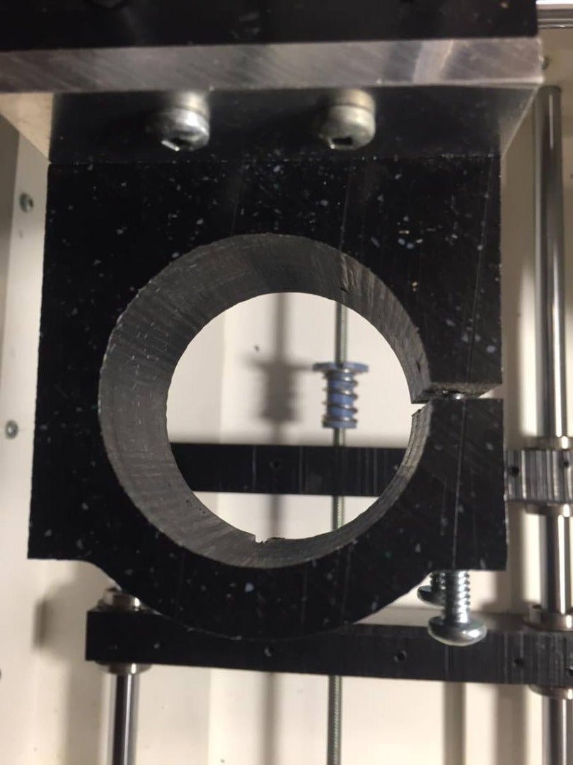

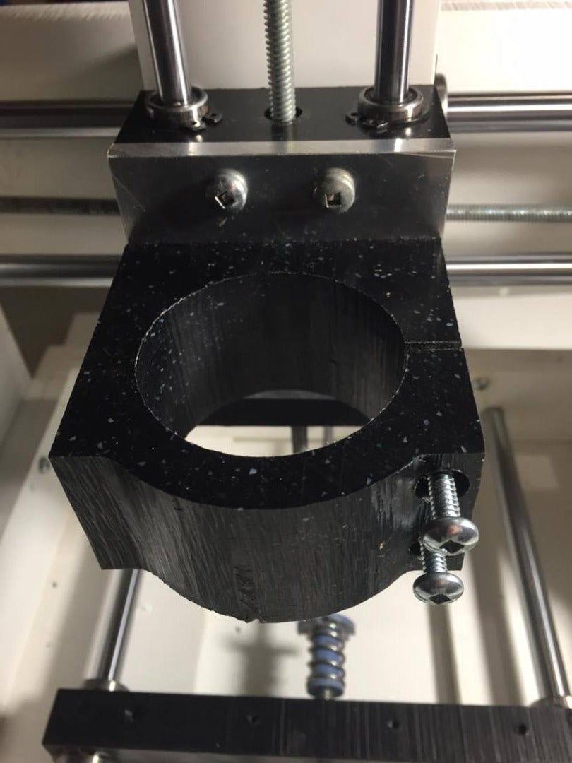

Cut and drill the ¼” thick aluminum plate to specs in drawing or you can use HDPE plastic.Cut UHMW plastic to 3” x 3” block by 1 ½” or whatever thickness you managed to pick up.Cut out center of block with in my case a 2 1/8” hole saw check the diameter of your rotary tool.Remove excess I have outlined in red with a bandsaw.Set your table saw to make the notch on the side.Drill and tap four holes on back,drill and tap 2 holes on front deep enough to go past gap on side.Drill 3/16” holes to allow clearance to tighten to provide clamping action.Use 1”10/24 screws to fasten mount to plate and use 2- 1 ½” 10/24 screws for clamping router.

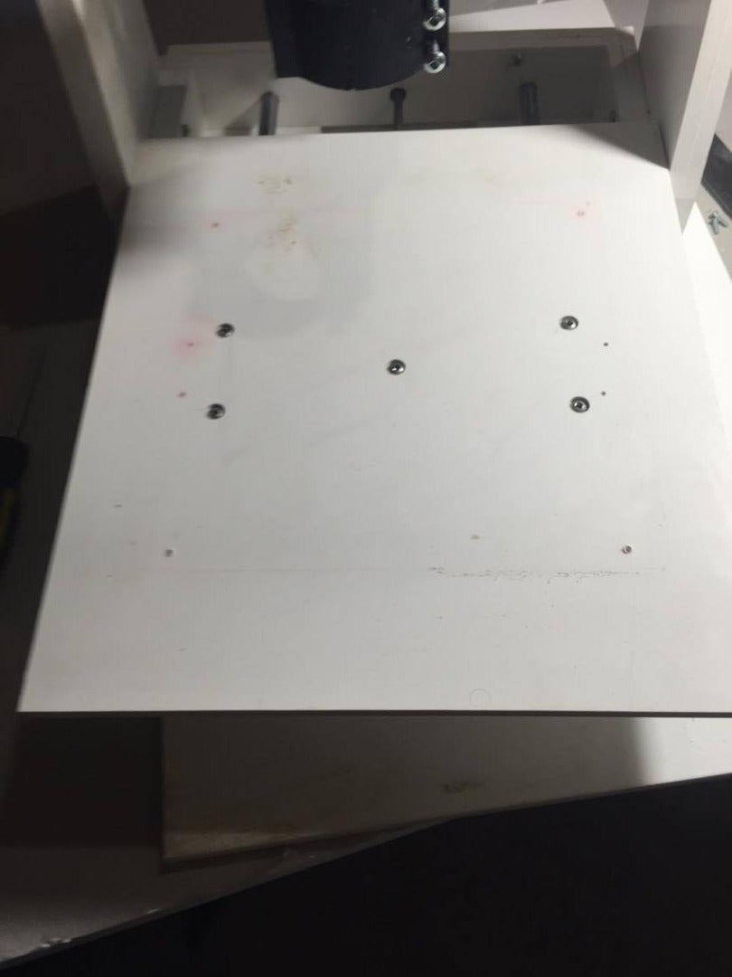

Table adapter plate is cut out of 5/8” thick UHMW after cutting to size drill 3/8” holes 3/16” deep with a forstner bit then drill the 3/16 holes all the way through then drill 1/8” holes to attach table top.Fasten block to X bearing blocks using 1”#8 screws then fasten table to block with 1”#8 screws. I had a red piece of 1/4'” ABS plastic 8 ¾” x 8 ¾” I centered on the table for a spoiler board.
