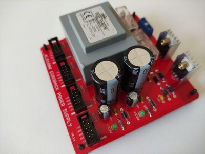

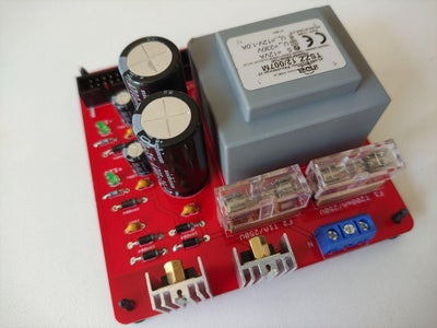

The PSU circuit I opted for is a single half wave rectifier with LM7812 and LM7912 voltage regulators.
It starts with a 12VA transformer with single winding at the secondary output that isolates all other circuits from being mains referenced. I wanted to get an AC-AC wall socket transformer to reduce the use of precious PCB space, but they are rare as unicorn poop, then I had to source a readily available PCB mount transformer (Indel TSZZ12/007M).

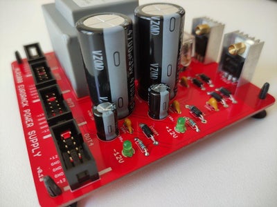

A couple of big 4700 uF filter capacitors and center tapped diodes bridges linearize the current before entering the two voltage regulators.
Two diodes across input and output of both regulators protect them in case of a short at their input.
Both primary and secondary parts of the circuit are fuse protected.
Notice that the Eurorack standard asks also for a +5V line. This PSU doesn't produce +5V but only +12V and -12V, so another PSU could be needed for some module to work.

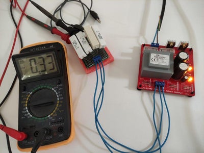

I tested this PSU with 15W ceramic resistors, and at 660 mA of total current the transformer was getting too hot to be touched. This is the demonstration (was it really necessary?) that the rating of the power transformer cannot be transposed to the whole PSU circuit directly.
During operation the transformer can go hot. Durning my testings in a ventialted open space at less than 350 mA total, transformer temperature was moderate (felt hot to the touch, but I could stay in contact without burning my skin), but if you plan to place this PSU in a closed space (your modular's chassis) it is well likely that temperature will rise, possibly to failure levels.
Without further testing then, I would not load a design like this more than 400 mA total.

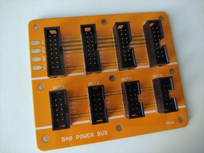

While designing the Linear Power Supply PCB, I forced myself to keep dimensions within the 10 cm x10 cm limit in order to keep board costs low. When I realized that only 4 power connectors could be accomodated in the remaining space (3 in the final design, see next step), I decided to draw an auxiliary board: a power BUS bar.
This is a very simple design, made of 4x10 pins and 4x16 pins IDC connectors, all respecting the eurorack pinout.
The BUS board also has solder pads for each required voltage (+12V, -12V, +5V, GND), so that you can use it with any external power supply of your choice.
One of the pictures attached show the bus bar "in action" on the bottom of my custom-made chassis. Being that I am a fan of screw terminals more than IDC connectors and thanks to the spacing between contacts, I use the PCB to host both.

In this case, the Power Supply prototype pictured misses a screw terminal to adeguately bring power to the Power Bus Bar. I have anyway soldered one on an IDC slot (IDC spacing and Eurorack pinout combined allows this), but is not nice looking obviously. The PCB version I shared in one of the previous steps accomodate a 3 pins screw terminal and 3 2x5 pins IDC connector.
I also increased the distance between the on-board transformer and other components, in particular those big 4700uF capacitors. During operation the transformer could go hot, so even if the distance has been increased in the final design, use 105°C rated electrolitic capacitors.
In the latest design, I increased the clearance between primary and secondary circuit.
Some improvement also affected the Power Bus Bar: even if the layout is essentially unmodified, there was room for three LEDs and three corresponding current limiting resistors. This gives the user a visual feedback of the presence of the three DC voltages (+5V, +12V and -12V), a welcome addition especially if the Power Supply doesn't have any.
