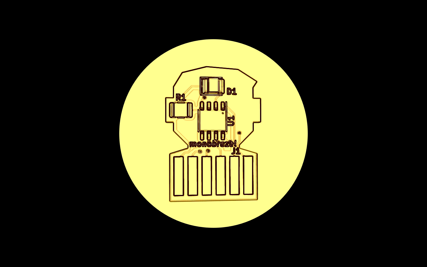

Step 1: Creating the PCB Edge Connector Footprint
Let's recall a little bit ... we want to insert our wearable device in an edge connector similar to the green one above.
For this, we need to create a male connector footprint matching the dimensions of the first female connector.
First of all, we need to have 6 PADs in our footprint. Based on the technical documentation, we can find following relevant information:
  • the pitch ( distance between PADs) is 2.54mm
  • the thickness of the board to be inserted can be between 1,45 and 1,82mm
  • the device can be inserted 7.9 mm in the female connector
  • the PADs main contact is at depth of 4.1mm
  • and the width of the edge connector male has to be smaller or equal to 17.8mm
those are the constraints for our PADs.
Let's define our design steps:
  • create a raster of 6 PADs with distance 2.54mm. There is an option for this in most of ECAD tools
  • manufacture a PCB with thickness of 1.6 mm. Standard by many PCB suppliers
  • PAD height 7mm and PAD width 1.7mm
  • connector width 14.7mm
by doing this, we fulfill all constraints listed before.
Check the final footprint in last picture

Step 4: Creating the PCB and Last Comments
On the top layer, we place the edge connector footprint, the micro and LED. On the bottom layer we place the battery holder.
And the last step is to define a nice shape for our device :)
