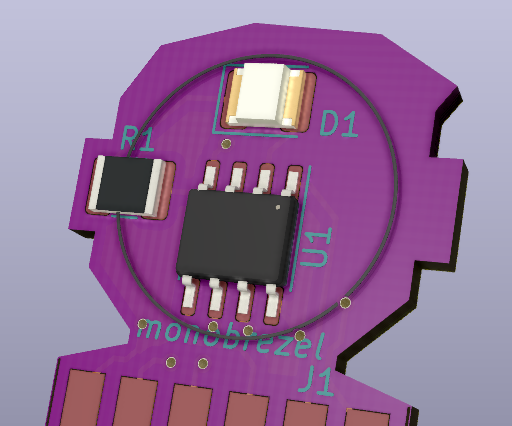

I was working on my programming tool's setup for wearables during the last months. Today I would like to share how I created my Arduino Shield.
After googling for a while, I found this interesting old article Attiny programming shield , which inspired me to create my own one.
This shield is Arduino Uno compatible and is intended to be used with different ATtiny uCs in following packages PDIP/SOIC/TSSOP, yes.. SMD packaging as well :)
Let's define the project constraints:
  • Arduino Uno compatible
  • ATtiny25/45/85, ATtiny24/44/84 and ATtiny2313A/4313 compatible
  • PDIP/SOIC/TSSOP compatible
  • SMD packages are supported by using a PCB edge connector

  • On the other hand the SMD package chips are part of a mini PCB device (Wearable). The PCB to PCB plug interface has 6 pins. It can be inserted/removed from the PCB edge socket ( similar to mini PCI interface for a PC mainboard). In above picture you can find the connector used in this board as well.
The last is an optional feature, you can remove it from your schematics based on your needs. You can find under this link ATtiny-Wearable-Device-PCB-Edge-Connector an explanation on how to create a mini PCB for this purpose.

Refer to above picture for details, please use the SMD capacitor footprint as indicated and for the PCB edge connector use a THT 6 Pin header ( the pitch is 2.54 mm, no 3D model is available).
Step 3: Creating the PCB
Let's explain the main approach of the PCB layout:
  • on the back side we place only the PADs to connect to our Arduino Board.
  • on the upper side, we want to have the DIP sockets, mini PCB socket and status LEDs as well.
Based on this great Arduino description Arduino Uno Drawing, we can start to place the shield connectors on our layout (check pictures above). As a good practice we change our measurement units to inches, in order to reduce the distance calculation effort.
