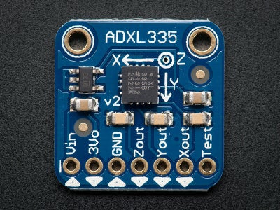

The ADXL335 is a small, thin, low power, complete 3-axis accelerometer
with signal conditioned voltage outputs. The product measures acceleration with a minimum full-scale range of ±3 g. It can measure the static acceleration of gravity in tilt-sensing applications, as well as dynamic acceleration resulting from motion, shock, or vibration.

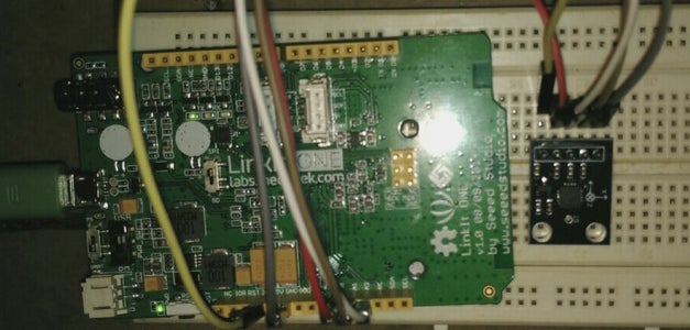

Step 2: Connections
VCC : 3.3V
On Board
GND :Ground
X_OUT: A0
Y_OUT: A1
Z_OUT :A2
Step 3: Code,Compile and Run
Upload The Code And You are Ready To go!!!! You have succesfully made a friendship between ADXL335 and Linkit One Board...
