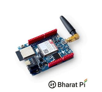

In this project, we are using Bharat Pi which has both an ESP32 microcontroller and a SimCom A7672S 4G/LTE module.
Bharat Pi is an IoT prototyping board for students, innovators, startups, and developers. A simplified board with an all-in-one compute, network and storage on a single board to build rapid prototypes.

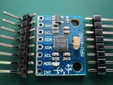

Step 1: Accelerometer
The MPU6050 is a popular integrated circuit (IC) that combines a 3-axis gyroscope and a 3-axis accelerometer into a single package. It's commonly used in various projects and products for motion sensing and tracking applications.
The MPU6050 integrates both accelerometer and gyroscope data and provides a convenient way to access this information through an I2C (Inter-Integrated Circuit) interface. By reading data from the MPU6050's registers via I2C communication, you can obtain real-time measurements of acceleration and rotation, which can be processed and utilized for various purposes in your projects.

Pinout of the Accelerometer Sensor :
Accelerometer Sensor - ESP32
VCC - Power Supply
SCL - SCL
SDA - SDA
GND - GND
Wire the Accelerometer sensor to the ESP32 as shown in the following schematic diagram. We’re connecting the vcc pin to 3v/5v and the sda pin to sda, scl pin to scl of esp32, and GND pin to GND of esp32.
ESP32 Wiring With Accelerometer Sensor :
VCC - 5V / 3V
GND - GND
SCL - SCL
SDA - SDA
