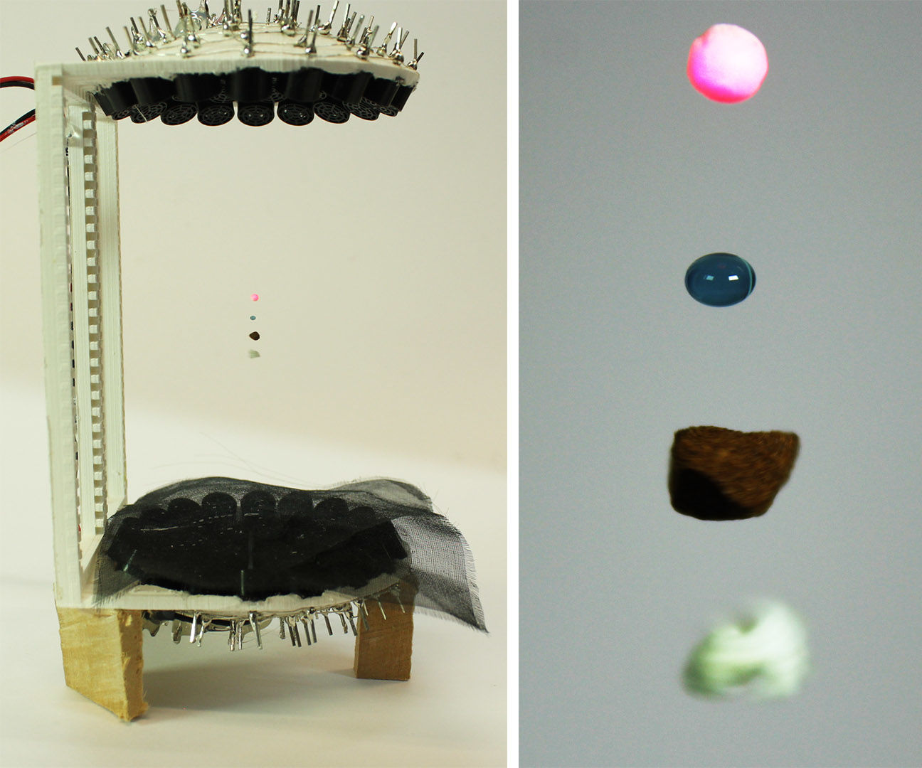

Introduction: Acoustic Tractor Beam
Tractor Beams are mysterious waves that can attract particles towards the source. Here, we will show you how to build an Acoustic Tractor Beam with components that can be bought directly on the Internet for less than 75$.
With this Instructable you will be able to get in your hands a device that it was only seen on SciFi movies such as Star Wars or Star Trek.

Step 32: Switch on and Levitate
Switch on the device, you should be able to feel a little bit the sound, or hear it if you point it into a big chunk of expanded polystyrene or foam.
Using an acoustically transparent sheet or tweezers you can place particles in the centre of the bowl (above 1.8cm approx) and they will be levitated.
Push the buttons to move the particle up or down.
Depending on the size of the particle and how close it is to the bowl, you will be able to levitate it laterally or upside down. It is also possible to levitate particles that are resting on a surface.

Hello,
Last post was 7 months ago I would like to know if I can still ask questions here.
I made the device but it keeps bumping the polystyrene particle out of the bowl.
I think I have the correct driving signals and dont understand what is wrong.
Thank you for your help.
Jean and Philippe
Best Answer 1 year ago
Looks amazing, could you send me privatly to asier.marzo @ unavarra.es a video of the issue. I am sure we will be able to solve it in now time together.

Trying to get this to work. Its will affect plate of water and move pieces of foam against table when upside down. I believe that the transmitters must be certain type as I can see no error. Check my video here to watch me debug my unit
https://youtu.be/hqNPj2AefeY
