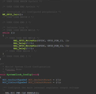

Step 4: Entering the Code
Locate and Open the main.c file (located in Core>>SRC>>main.c) & and add the above code in While(1) Loop
HAL_GPIO_WritePin(GPIOC, GPIO_PIN_13, 1);
HAL_Delay(500);
HAL_GPIO_WritePin(GPIOC, GPIO_PIN_13, 0);
HAL_Delay(500);
Here we have used Pin 13 beacuse it has the internal LED Connected to it

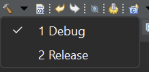

Step 5: Debug
Click on Debug

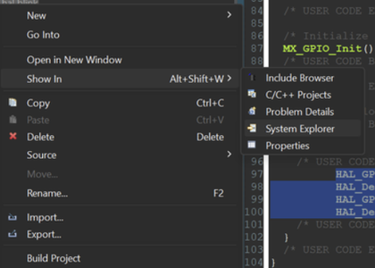

Step 6: Locate File Locate in System
Right click on Project and click on show in system explorer and copy the path

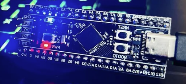

Step 9: Done, LED Is Now Blinking
