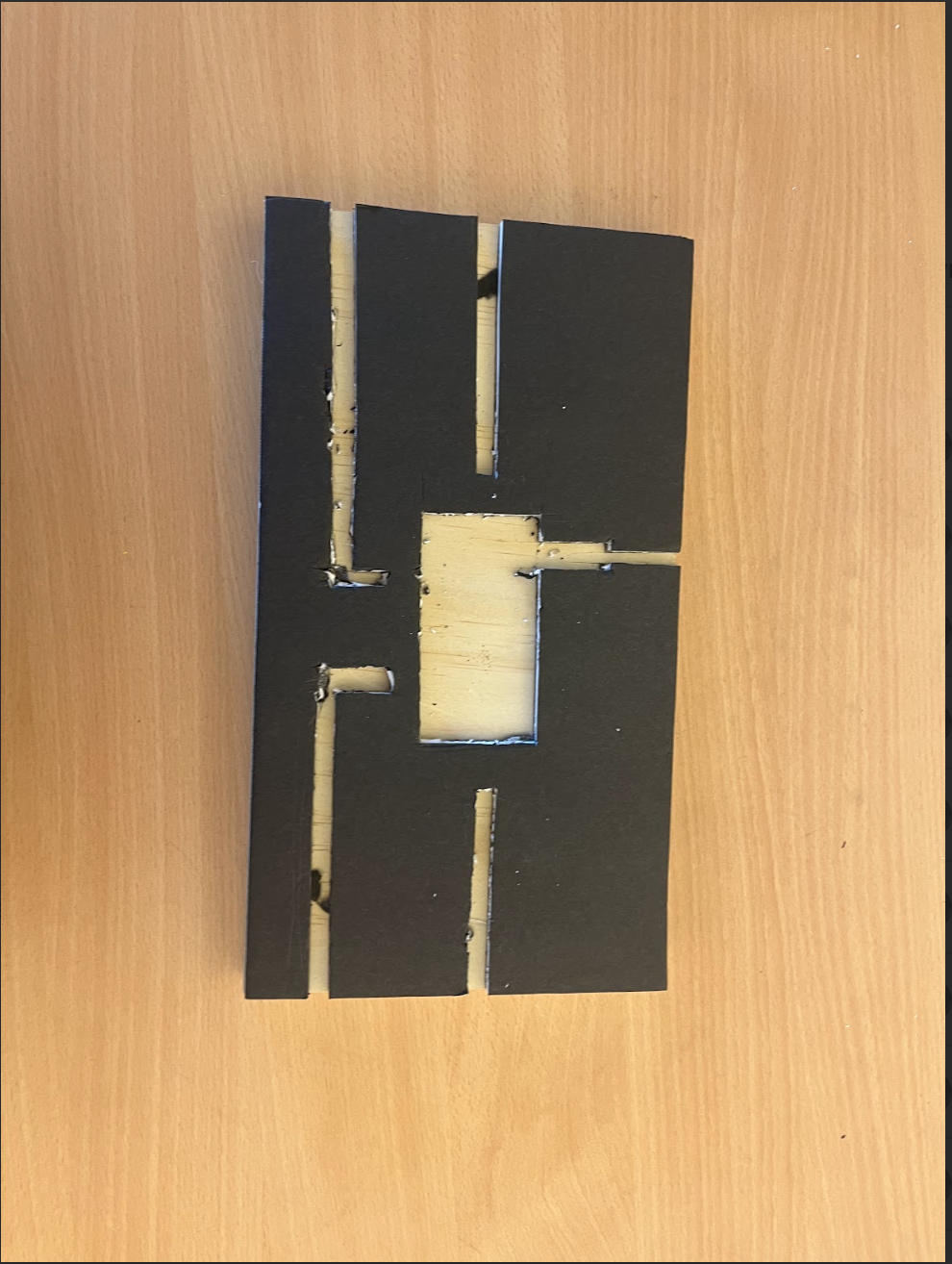

Step 13: Create Base for Central Hub
  1. Glue together 3-4 pieces of foam core, each measuring 12 x 7 inches.
  2. Cut out channels in the foam core to roughly resemble the channels in the reference image.
Now, you have a larger foam core structure with channels that match the image provided.
