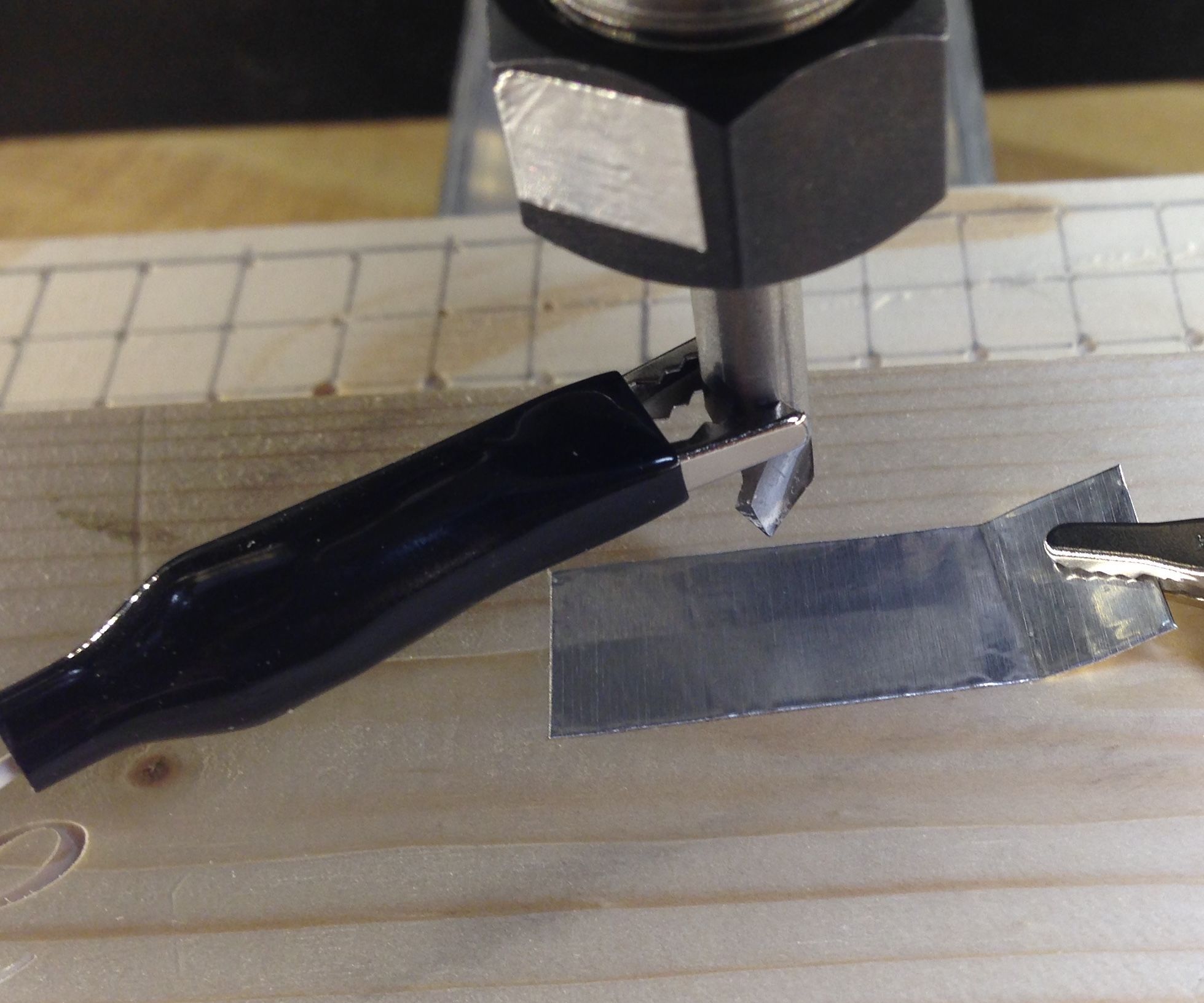

Step 18: Add Reflective Tape to One Side of Collet Nut
Use a small strip of aluminum tape (used for furnace ducts) and attach it to one facet of the collet nut. This reflective tape will allow the IR optical sensor to pick up a single revolution of the spindle.
Step 19: Ensure the Reflective Tape Does Not Go Over the Edge to Adjacent Facets
The tape has to be on one side of the collet nut only. The tape is thin and light enough that it does not interfere with the wrench to change end mills or affect spindle balance.
