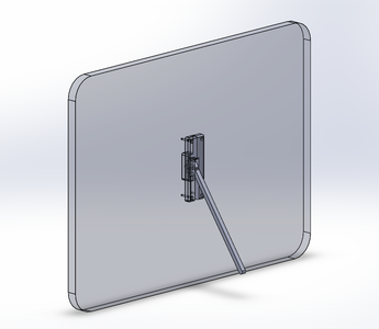

I brainstormed lots of ideas initially, but given the materials I could get and manufacture, I opted for a gear-shaped mechanism I came up with for the adjustment of the book stand. The idea is that the metal stick holding up the book stand will have an oblong hole at the end, which allows the stick to be pulled out of each individual slot and adjusted to a new angle. The stick can then be pushed into the new slot, securing it in place (as shown in the first sketch). This end of the stick will be sandwiched between two shells, which are secured to the wooden board.

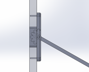

The next step is to create and dimension the book stand using CAD (Computer Aided Design). You can use CAD/CAM software like Fusion 360 to do this. The dimensions for each part are in the second picture of the previous step (the dimensions are all in cm). Next, I used CAM to translate the CAD into instructions for the CNC mill to visualize the manufacturing process.

For each metal shell, secure the 9mm aluminum, and cut the face with the gear-shape first. Then, rotate the object to cut the holes for the screws. Finally, rotate the object again to cut the final part (as shown in the second picture).

After cutting out all the parts, it is time to assemble the book stand. First, place the oblong end of the metal stick in between the metal shells as shown in the first picture.
Then, insert the rectangular shape that extends out of the metal shells into the rectangular hole on the wooden board as shown in the second picture.
