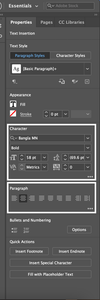

Once the information is typed up, we can begin adding adjustments such as the font type and size. Highlight the specific text and within the Properties Panel on the right side of the page, options will appear to change the text.
Under the section Character and Paragraph panel, change the options of the font, text, and alignment. Free feel to choose any font or size of your own preference.

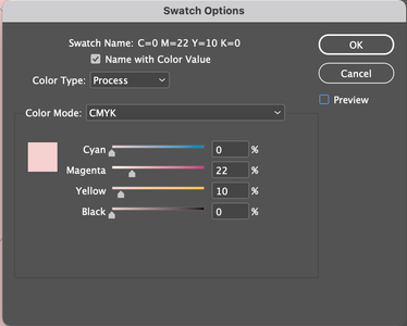

Once drawn, navigate to the Properties panel and under Appearance, select the Fill, and click the new swatch button. Double click on the new swatch and adjust the colors to your own preference. Remember, bright colors can help draw attention to your poster.
Here were the CYMK settings I placed for my color background:
  • C - 0
  • M - 23
  • Y - 10
  • K - 0
Once you select your color swatch, click on the box you previous created and select the swatch you created and the color should appear.
