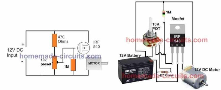

Step 1: Wiring
How to Wire this Project:
The wiring may seem daunting at first. But the circuit is straightforward. There are many different ways to wire this. Some may find it easier to use an Arduino, while others rather not have to deal with a microcontroller. This part is entirely up to you, and both have Pros and Cons. I opted to make my circuit without a microcontroller. I have included a link to the Tinkercad circuit design so you can play with it and understand how it works. I also provided a link for a tutorial on how to wire the motor controller as it can be a little difficult to understand.
Tinker Cad Circuit Diagram
Motor Controller Circuit Explanation
Basic Circuit Connections:
The 2nd and 3rd images show the motor circuits. The 2nd image is just the basic circuit, whereas the 3rd image includes a switch and an LED to indicate power. I would highly recommend looking at the images provided, the main circuit, and the links I provided above to understand the pinouts. But here is a basic pinout for the main circuit:
MOSFET Connections:
  • Gate Pin (The Left Pin): Connected to the Wiper Pin (Middle Pin) Of the Potentiometer. Connected to the 1m Resistor(The 1m resistor is connected to the negative terminal on theBattery Box)
  • Drain Pin (The Middle Pin): Connected to Side B of the Switch. (The Switch is connected to the positive terminal on the Battery Box)
  • Source Pin (The Right Pin): Connected to the positive terminal on the Motor
Potentiometer Connections:
  • Terminal 1 (The Left Pin): Connected to the negative terminal on the Battery Box.
  • Wiper Pin (The Middle Pin): Connected to the gate pin on the MOSFET (Mentioned in the "MOSFET Connections)
  • Terminal 2 (The Right Pin): Connected to 470ohm Resistor. (The 470ohm resistor is connected to Side B of the Switch)
LED Connections:
  • Cathode (The Short Pin): Connected to the negative terminal on the Battery Box
  • Anode (The Long Pin): Connected to the Side B of the Switch
Switch Connections:
  • Side A: Connected the positive terminal on the Battery Box
  • Side B: This is where all of the connections to the Switch mentioned above actually connect to.
Motor Connections:
  • The Positive Terminal: Connected to the source pin of the MOSFET
  • The Negative Terminal: Connected to the negative terminal of the Battery Box
Buzzer Connections:
  • Negative Terminal: Connected to the Handle, Connected to the negative terminal of the Capacitor (The wire that connects to the Handle needs to be around 6ft long)
  • Positive Terminal: Connected to Side B of the Switch, connected to the positive terminal of the Capacitor (Remember this wire has to be 2.5-3 ft long)
Wacky Wire Connection:
  • The Wacky Wire is connected to the negative terminal of the Battery Box (This is done by utilizing one of the holes in the metal four-hole bracket, See more in step 8)
Important:
The wiring diagram includes two circuits. The buzzer and motor circuits. The motor circuit is fully housed inside the Electronics box. The buzzer circuit is housed inside the Buzzer Box. Two wires connect the circuits. The positive wire from the battery box goes directly to the positive terminal on the capacitor in the buzzer box. Then a ground wire directly from the battery connects to the "Wacky Wire". Then the handle is attached to the ground terminal on the capacitor via a wire. This way when the handle makes contact with the "Wacky Wire" the current passes through which triggers the alarm. Again this is all explained in the TinkerCad Circuit. (See step 8 to see how the ground wire attaches to the Wacky Wire)
