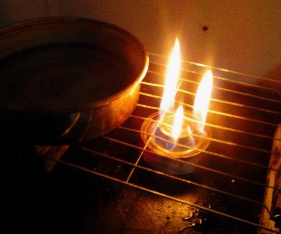

Step 2: Step 2: Assembly.
First remove the cap from the salt/pepper shaker. Next use the nail to enlarge the center hole on the cap from the top.
Take a small piece of aluminum foil and fold it into a 1" x 1" square. Place this square into the inside of the cap. Screw the cap back onto the glass component. There should be a snug fit.
Next, take the nail and push through the top of the cap and through the foil to make a hole.
Cut a 3" segment of the clothes line and place the segment through the top of the hole until the remaining top half inch is left exposed at the top.
Step 3: Step 3: Fill and Light
At this point, all that remains is filling your candle. Unscrew the cap and fill to just half way inside the neck of the glass segment. Place the line end back in and screw the cap back on.
Allow a minute for the alcohol to soak into the cotton line, otherwise you're just burning line needlessly.
