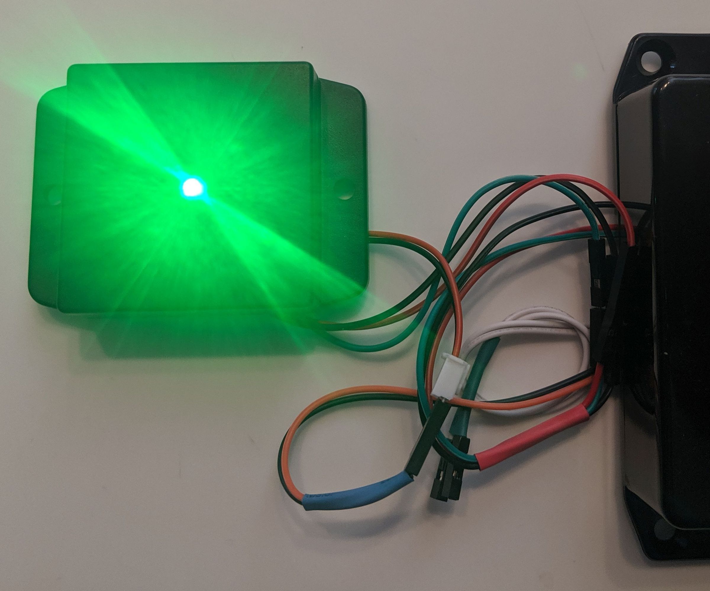

Step 2: The Build:
The NodeMCU and the N/O relay are mounted on the perf board to facilitate wringing and mounting in the flanged case.
There are only 3 NodeMCU pins used: D1 (GPIO 5) to control the LED, D2 (GPIO 4) to control the relay and the GND pin for the relay and the LED.
There are 2 pigtails connected to the relay that are connected to the door opener switch terminals.
Power is provided by a standard USB 5VDC power adapter through the NodeMCU onboard microUSB connector.
The LED blinks 3 times on startup to signal a successful wifi connection and, after the connection is made, the LED blicks very 5 seconds to provide a "heart beat" indicating that the program is still running. If a reset is needed, simply cycle to power to reset.

Step 4: The Install:
Lastly, at the garage door opener, connect the 2 pigtail leads to the terminals that the opener switch is connected to. If there already are wires attached to the opener terminals, make sure that you connect these wires in parallel with the existing wires.
When first installing the opener, I recommend that you connect the opener to a lap top that has the Arduino programmer software installed. This will allow you to use the programmer's serial monitor to watch the opener connect to your Wifi network. Because a garage isn't usually an area that people are concerned about Wifi coverage, it's possible that the opener may have trouble connecting to the network. If that's the case, you'll have to adjust your Wifi network to improve the coverage for the garage opener. Think mesh routers, new and improved routers, bridges, etc.
When everything is working correctly, disconnect the opener from the computer and connect it to the 5 volt power adapter and you should be ready to go.
