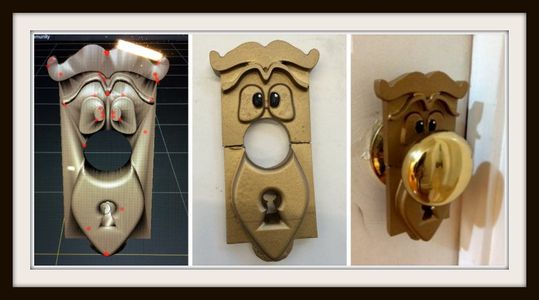

Step 1: Modeling the Part in SolidWorks
Above is a peak at the progression from design to finished product.

I played around with my doorknob and determined that it most definitely could not be taken apart without cutting straight through the piece. Thus, I knew I'd have to mold two parts that could fit around the knob. I started off by making my model in SolidWorks. I imported an image of the character and traced it, then extruded in varying degrees.
Note: To trace an image in SolidWorks, create a new sketch and then import an image of your choice via Tools->Sketch Tools->Sketch Picture. You can then use the standard drawing tools to sketch over the image.
Alternatively, you can just use my Solidworks file (AUGUST 2016 UPDATED LINK: https://www.dropbox.com/s/w4diswk5mksqgdl/doorknob.SLDPRT?dl=0) , if you give me credit :)
I hoped to add more texture than Solidworks allowed, so also played around with Autodesk's Mudbox (first image above), a truly remarkable program that lets you push and pull meshes around like a block of clay! Although I had a lot of fun playing around, I worried that the design might come out looking messy, and so ultimately opted to print the flat version and save some more subtle work with Mudbox for another time. [Pro tip: if you'd like to use Mudbox with a SolidWorks file- you'll need to use Meshlab to convert from STL to OBJ formats).

My side borders were far too fine, and as a result were completely cut off. I also forgot to add some depth to the cut. I ended up recutting right below my original cut, but at the bottom you might notice that somewhere in this process I accidentally cut a bit more deeply. I tried to repair the piece with hot glue, which turned out not to be the best solution since it left some unwanted texture to the doorknob's chin. Fortunately It's not extremely noticeable! I might have been better off repairing with putty, but couldn't find any around.

Step 4: Attach to Doorknob
Finally, I hot glued the pieces onto my doorknob. It would have been better if I had managed to take apart my doorknob and do a one pieces mold. Another option would be to 3D print or mold/cast a piece for the back of the face so that it sits more cleanly on the knob. But for my immediate purposes, hot glue worked just fine.
And there you have a talking doorknob :)
