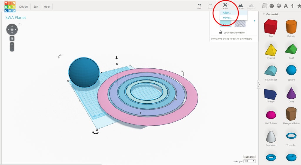

The Align Tool can be found in the Adjust menu, at the top right corner of the screen. When finished, it will look like the image below.

  1. Select the inner most ring. Add the planet to the selection by holding SHIFT before left clicking the planet.

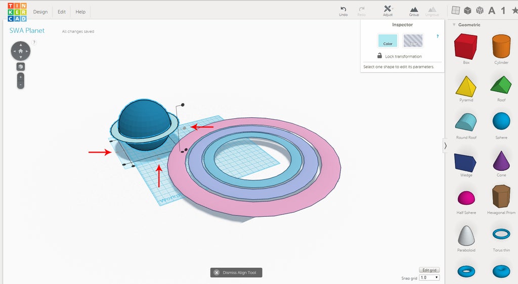

  2. Choose Adjust>Align. Left click on the planet so that the ring will move toward the planet. Select the center tabs on all three axes.
  3. Repeat steps 1 and 2 until all rings are centered on the planet.

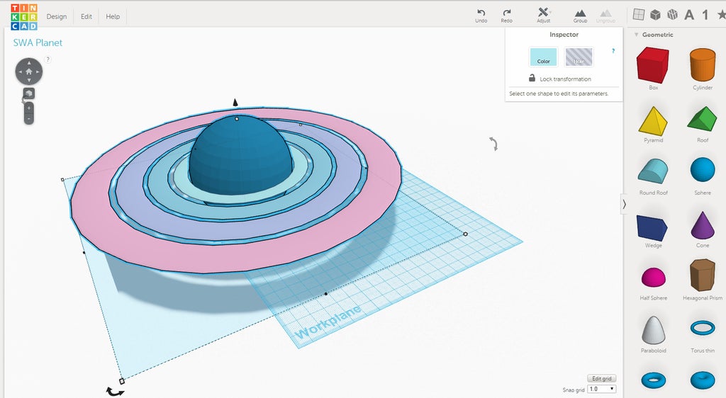

  4. Select all of the rings and rotate them on either the Y or X axis. Good job! You have completed a ringed planet!
