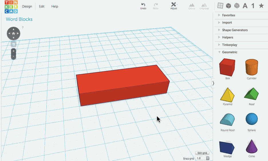

Step 2: Add a Block to the Workplane
In this step, you will add a block to the workplane.
Instructions
- Drag a block to the workplane.
- Re-size the block so it is 20mm deep and 10mm high. Set the width to the measurement you calculated in the previous step.
- Continue to the next step.

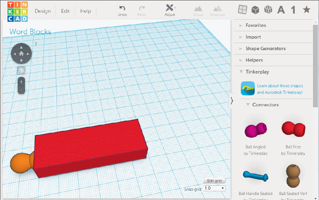

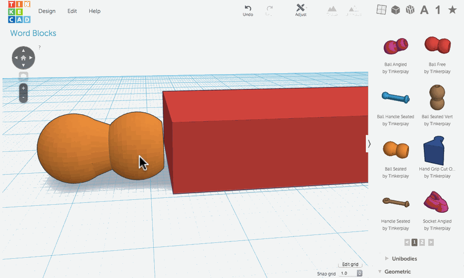

Step 3: Add and Position Ball Connector
Now you will add a ball connector to your Word Block.
Instructions
- Find "Connectors" in the "Tinkerplay" panel of the shapes pane. Add the shape labeled "Ball Seated" to the workplane.
- Position the ball connector so its right side is 1mm away from the left side of your Word Block.
- Make sure the "Snap grid" setting is still on the "1.0" option.
- Use the right arrow key to move the ball connector over 5mm. Pressing the arrow key five times will move the connector 5mm.
![](https://content.instructables.com/FJG/E6I6/IRXSUV6J/FJGE6I6IRXSUV6J.gif?auto=webp&fit=bounds&frame=0&height=1024&width=1024)
![](https://content.instructables.com/FFE/FW6C/IRXSUV6K/FFEFW6CIRXSUV6K.gif?auto=webp&fit=bounds&frame=0&height=1024&width=1024)

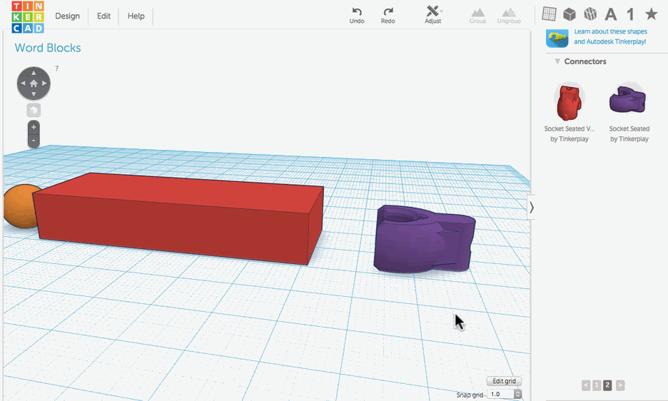

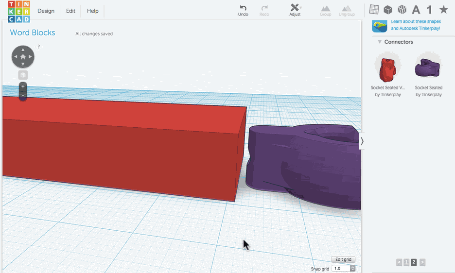

Step 4: Add and Position Socket Connector
Next you will add a socket connector to your Word Block.
Instructions
- Add the shape labeled "Socket Seated" to the workplane.
- Click on the socket to select it. From the Adjust menu, Click the "Mirror" option. Click the middle arrow to flip the socket around.
- Position the socket connector so its left side is 1mm away from the right side of your Word Block.
- Use the left arrow key to move the ball connector over 5mm. Pressing the arrow key five times will move the connector 5mm.
![](https://content.instructables.com/F94/9VHB/IRXSUV6L/F949VHBIRXSUV6L.gif?auto=webp&fit=bounds&frame=0&height=1024&width=1024)
![](https://content.instructables.com/F8A/78HT/IRXSUV7H/F8A78HTIRXSUV7H.gif?auto=webp&fit=bounds&frame=0&height=1024&width=1024)
![](https://content.instructables.com/FNY/43UG/IRXSUV7I/FNY43UGIRXSUV7I.gif?auto=webp&fit=bounds&frame=0&height=1024&width=1024)
