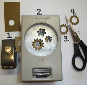

Step 5: Making the Gears
The gears are made from the spare squares of book pages left when the hole from the clock mechanism was made. From those pages I cut out about fifty 1.5 inch diameter circles, fortunately I had a punch which made this task easy (now if only you could get a gear shaped punch). I divided the circles into two piles of 25 and glued the pages in each pile together into a stack with a glue stick. Then I cut out the gear shape using a craft knife.
The first set of gears I made with square did not work so well, so I switched to an involute shape which I included as a template in the materials section. You can also make your own using this gear template generator. (Note; some of the images I used in the following step show the square toothed gear rather than the one I ended up using.)
