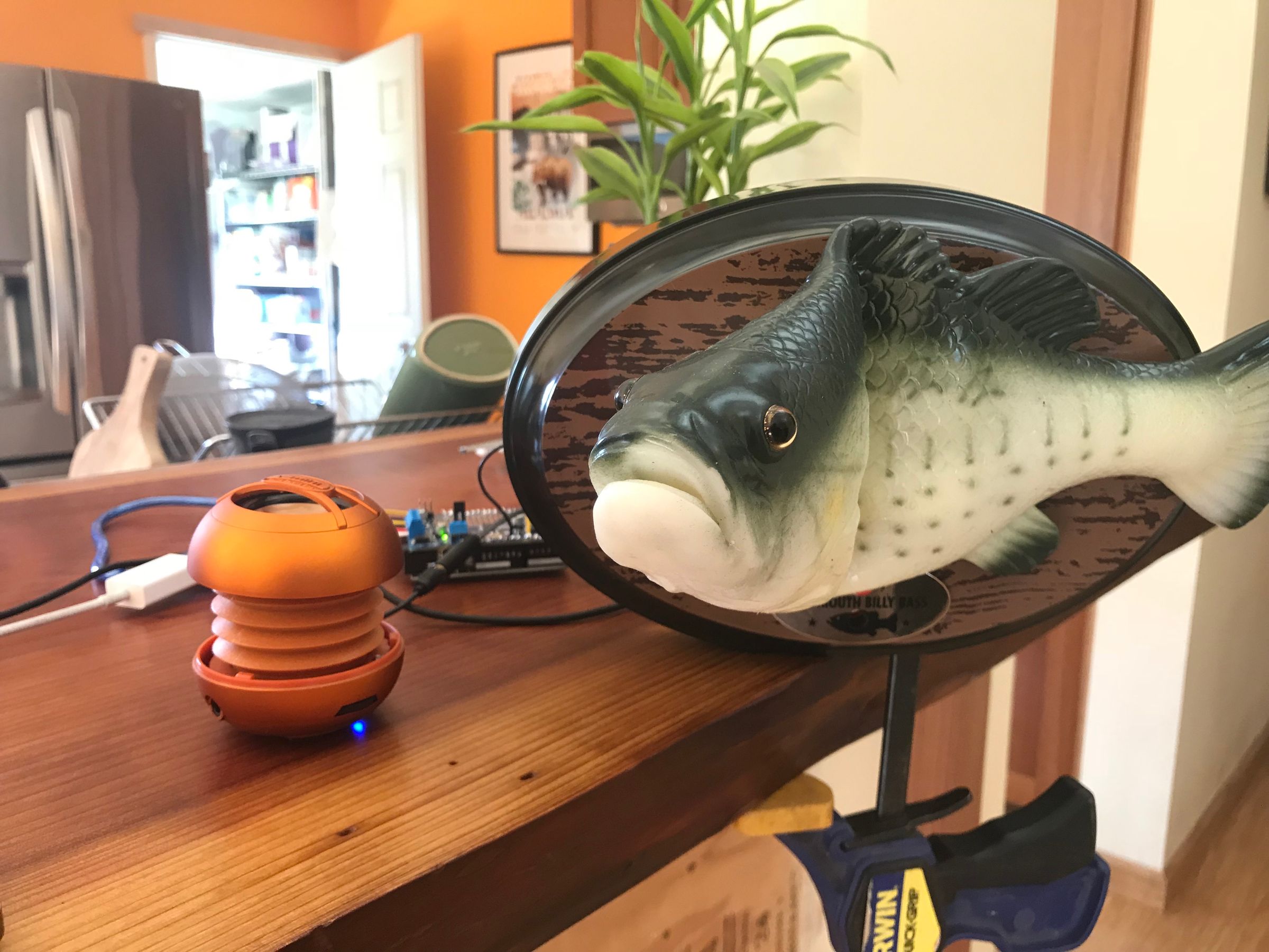

With the code loaded, and the audio cable connected to the jack, you should be able to make the fish’s mouth move just by connecting an audio source to the free end of the cable (I used my phone playing a podcast). If it’s working, drill a small hole somewhere on the plastic fish plaque, push the jack through and tighten it in place.
To get Alexa (or whatever you want) talking through your fish, connect the free end of the audio cable to the Y-adapter, the rechargeable speaker to the other input of the adapter, and then run the male plug of the adapter into the audio output of the Echo Dot.
Make sure your speaker is switched on and the volume is up on both the speaker and Alexa. Then, summon Alexa and ask her a question to get her talking (weather, jokes, news). You should hear her voice through the portable speaker while simultaneously witnessing your fish’s rubber lips flapping in time. The closer the speaker is to the fish’s head, the more uncanny the effect is.
If it’s all working out, the trick then becomes packing the speaker and Arduino into the Billy Bass enclosure and closing it up. Honestly, I’m still figuring this bit out.

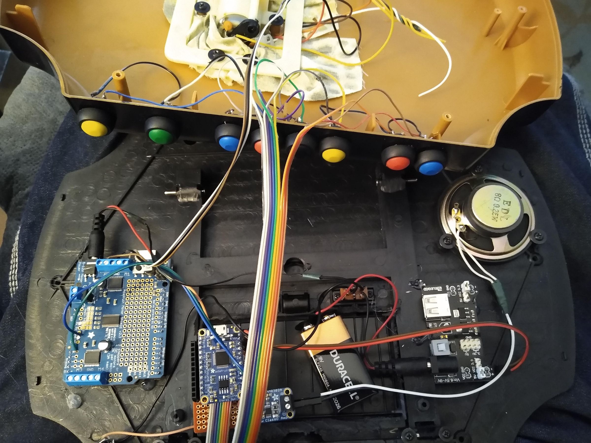

Some folks have asked me for the code I used to get the head and mouth movement at same time. I posted my code here:
https://github.com/jswett77/big_mouth/
Hope this helps. The one issue I have now is that voltage out isn't really enough to fully articulate the body. For example, when I hooked up batteries directly to the motor I could get more articulation than when I set the motor to 255. I measured the voltage out at about ~3V so maybe there is a max on the motor shield? (I really am new to hardware so I don't know if it is work aroundable)
Reply 5 years ago
The motor shield may drop too much voltage; when operating, there would be one transistor between ground and output, and one between input power and output. One could use a bit higher voltage, or find MOSFET drivers with less voltage drop (but capable of handing the amperage of the motors).
