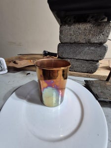

Step 1: Heating Up the Copper Sheets and Copper Mugs to a High Temperature-600 Degrees C.
Heat the hotplate on 3 to 4 bricks slowly to the max setting 5. A good hotplate should reach 500-600 degrees in 5 to 10 minutes. A hotplate requires constant supervision since it is dangerous to be left on without anyone around! Again, the table should have bricks placed on top to prevent the table from burning when you place the hotplate on the table. (Safety.)
  1. Using tongs or protective gloves (that can handle 600 degrees C) place the foil a few centimeters from the hotplate and allow it to anneal for a bit. The sheet, depending on the angle, will turn red, then pretty rainbow colors. Each technique produces different results. Protective gloves are much preferred over tongs (found out the hard way.).
  2. With the cups or mugs, you need clamps and support stands directly on the hotplate. You need the clamp to be 7 to 8 cm so u can place the metal directly on the hotplate. Using protective gloves (never do this without them) move the mugs, cups, etc around and heat the cups. Beware of fumes that may be generated; use a fan to blow the fumes away from you and open the doors to get the fumes to disperse. Proper ventilation is key here.
  3. A lot of the metal is trial and error. Thin foil at 0.001 cm thick (it can be ripped) is not practical, but the thicker foil can be heated for 1 to 1.5 minutes at 350-400 degrees C with your gloves put gloves on and place the foil a few centimeters on the hotplate. ((Center of the hotplate is the hottest). See supplies and Intro for more details.

We need to find an appropriate foil of copper that will be 0.01 cm thick, 5-6 cm in length, and 4 cm in width. Then we place the copper foil from Amazon into the frame. The plastic or glass frames will work the best. This is the tricky part (Getting the frame and the copper foil that has been annealed to fit in.
