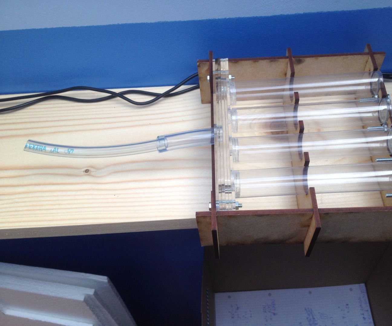

Step 3: Assembly
You'll need 4 screws of 3x20mm and aquarium silicone to assemble the nest.
You'll also need 3 aquariofilia tubes with an external diameter of 5 to 8mm.
The 3 MDF plates (if you use one large plate of 9mm it will work better) are glued together with aquarium silicone. Glue the plexiglass on both sides of the MDF. Your nest is almost ready!
After the silicone has dried, screw everything together to be sure. The screws must be tightened by hand. If you tighten it too hard, the plexi may break.
Then glue the aquariofilia tubes in the entries.
Once everything is dry, the nest is ready to use.
I left one exit open because I'm not sure if a Camponotus queen can pass trough the small aquariofilia tubes.
I'll post photos with ants in it when I have enough workers in my colonies.
