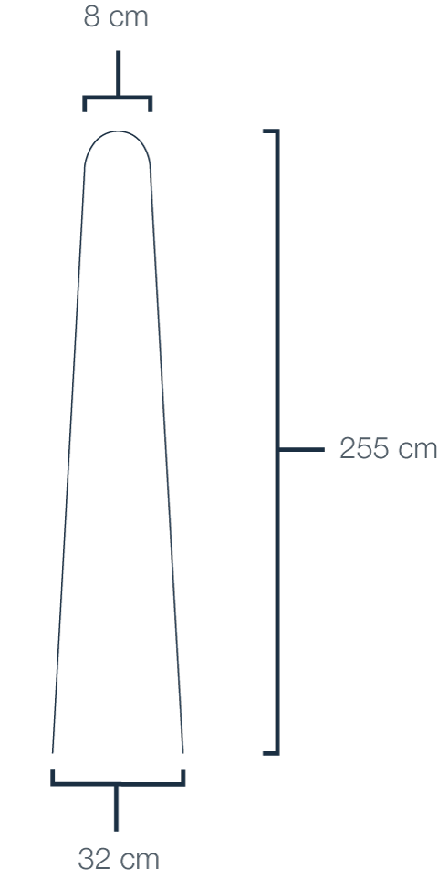

Once you have found a fabric which is suitable for this project. You will need a lot of it. Around 265cm in length, and 90cm in width if you want to re-create the exact same tentacle lamp. The pattern which I used is shown here. Is slightly cone shaped. Trying to emulate the shape of a tentacle. This shape adds more dynamic to the final form and it provides more surface at the bottom. Which can be exploited to create a wider, and therefor heavier, more stable foot. I drew the pattern directly onto the fabric, using a measuring tape and a black marker. But you could go all out fancy and cut a paper shape first. Or use a special fabric crayon. Most important is how you draw this shape the most easiest upon any surface. Whether it is on paper or textile. I drew 2 dots, 255cm apart from each other. Then I drew the two outlines on a 90 degrees angle. 8cm on one side, 32cm on the other. Using the 2 dots as the center point. Then using something long and (somewhat) straight to connect the dots together. Then I drew the same shape again. Normally I would just fold the fabric together. But with a pattern of this size. I would simply waste too much fabric. | ![]() |
Then I cut the fabric. If you keep the seam on the outside like I did, it is important to pay attention to the cutting and cut nice straight clean lines. If you want to hide the seams by turning it inside out after sewing. It doesn't really matter how clean you cut them. Now the fabric is cut, you can start sewing. This is a really straight forward process, since it is just 1 big line. Just put the two pieces on top of each other and use some pins to keep them together.

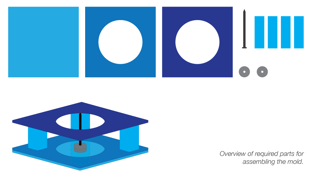

This step is a tricky one. It is not very difficult but it has two different factors which are related to the dimensions of concrete foot and therefore mold. The outer diameter of the mold and the center diameter. The center diameter equals the diameter of the rod + a tiny margin. I wrapped a piece of tape around a 4mm nail to comply with this extra margin. The outer diameter is related to the outer diameter of the fabric. This might seem complicated to measure, but it is rather simple. 1 Piece of fabric is 32cm in width on the bottom side. When you multiple this by 2 (since we have 2 pieces of fabric). This adds up to 64cm. This value represents the circumference of the concrete cylinder we want to pour. Because using the circumference for creating a circle is not very useful. We want to know the radius or diameter. Using basic maths, or an online calculator we can use the circumference to convert it to a radius or diameter.
circumference = π * diameter
diameter = circumference / π
in this case, the foot for this object needs to have a diameter of ~20.4cm. Because I had access to a laser cutter I made a super simple pattern and cut it out. But if you have not got a lasercutter you can achieve the same result consuming just in a little bit more time. But you can also just go rogue with this step and just use an old bucket. Glue a cap of something to the center. Pour the bucket with concrete and then drill the hole for the rod after the concrete has set. It is all up to you.
Making a custom mold
The pattern consisted of a circle of ~20cm in diameter + a smaller circle of ~5cm in diameter with a smaller circle of 0.42cm in diameter. The 20cm circle is for the foot. The 5cm circle is meant for the gap where the nut can hide in. The 0.42cm circle is the hole in the 5cm circle for the nail to go through. I then laser cut this pattern twice and cut 4 pieces of wood on the same length (slightly shorter then the length of the nail). Which ends up in having the following set of items/parts:
Besides the nail is everything made of wood. Assembling is just done with wood glue & screws. Use the image above as a reference of how the mold should look like. When you have assembled all the parts. The base for the mold is done. Now it needs to be sealed. For this I used a piece of transparent PVC (which just happen to have something printed on it, as you can see in the picture
). I rolled up the piece of PVC and put it inside the frame. To prevent leakage. I used a glue gun to seal the PVC with the wooden frame.
Now the mold is done, you can pour the concrete. The more you pour, the more stable the lamp will be. I advice you to use a minimum of 2.5kg ~10cm in height. But the more you pour, the better the result.
