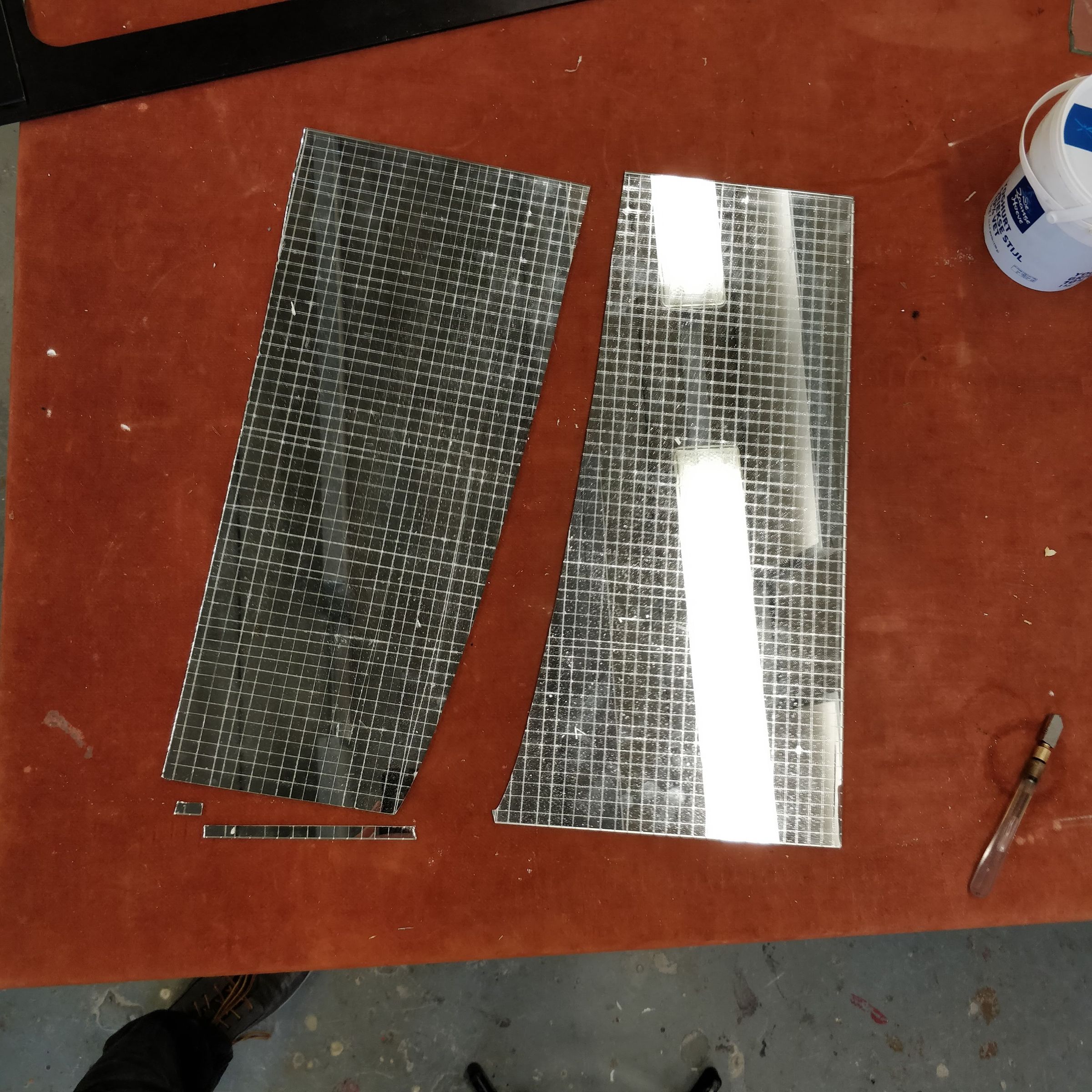

Before we can get this party we need to prepare. In this case, that means we need to cut our mirror into tiny pieces. The bad part of this is that this is really time consuming and very boring thing to do. The good part is, that this doesn't have to be done very precise. Ofcourse, the more precise you are. The better the outcome. But in practice it does not really matter that bad. As a matter of fact. It comes in really handy when you accidentally crack a piece diagonally, since these parts will become useful when you are working on the curved sections of your object.

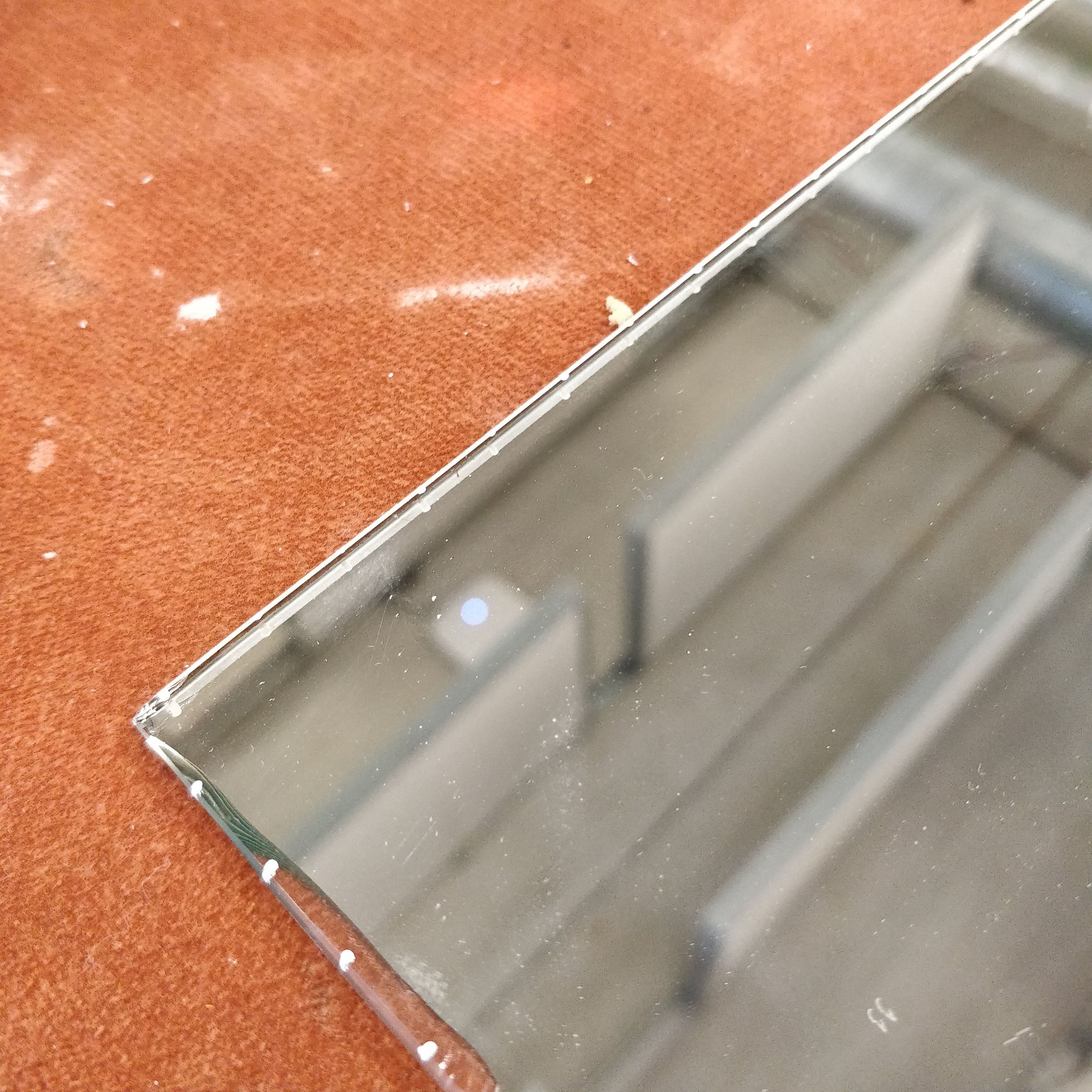

Cutting the mirror

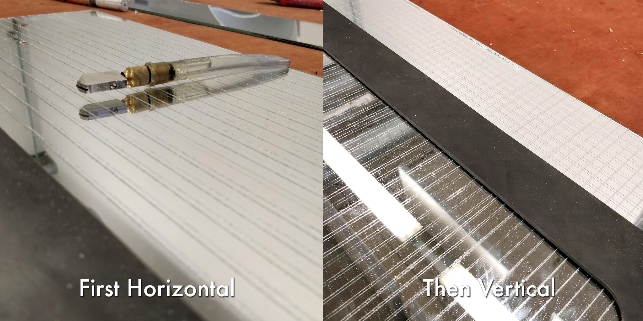

To cut the mirror you first mark two sides of the mirror with dots evenly spread across. I used a distance of 1cm for this. Which turned out to be a really nice size for the bottle I used. Making them bigger and it will be harder to glue them on sharper angles on your object. Making them smaller will increase the details of your end result, but will take you way more time to complete
After marking the glass, use the glass cutter to cut straight lines with the help of a square.
And embrace that you will make mistakes.
No seriously, it does not matter. That is one of the best parts of this project. Because of 2 reasons. One, you'll probably will cut more than you actually need in the first place. And two, you need non-rectangular and/or slightly smaller pieces anyway. Cause your chances of fitting all 1 by 1 centimeter pieces perfectly around your object are as good as 0%.
Now you have cut all the desired lines upon your mirror. It is time to break it into small pieces. For this you'll need the running pliers. I have no picture of using this tool - cause I can not take a picture and hold two items in both hands at the same time - but it is a fairly simple tool to use. Just make sure that the right side is up. The right side is the side which will break the glass nicely over the scratch with a light gentle press. Or the side which has a mark on it. If you need to apply a lot of force and it shatters everywhere, you have the wrong side up.

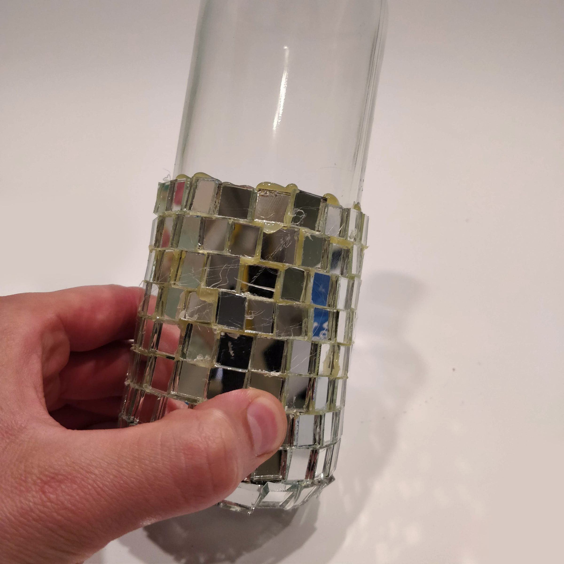

Glueing the pieces

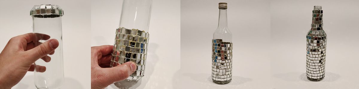

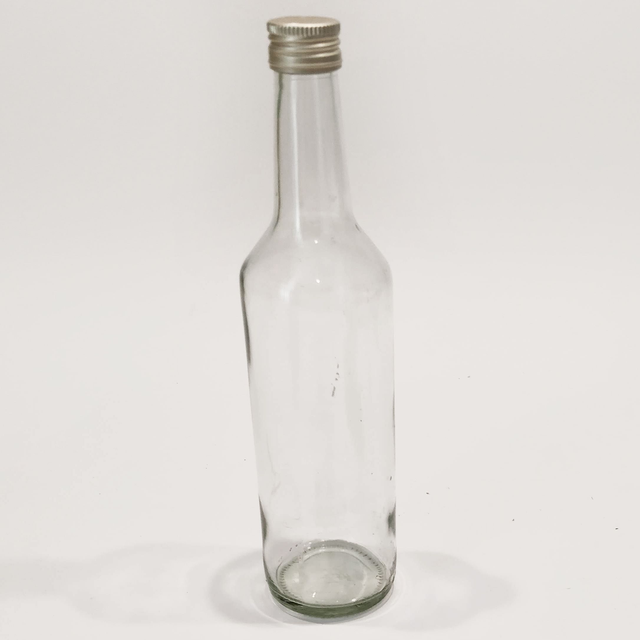

Now we have all the pieces cut, we can start with making the disco ball. I used an empty bottle for this. But you can should use any other object you'd like.
As with everything else which you apply something on. The object first needs to be degreased (and/or sanded). In order to make sure that the glue sticks and the pieces won't fall off. Also it is worthy to try beforehand, if your hot glue sticks to the material anyway, before realizing that it doesn't and all your pieces fall of after 12 minutes.
When the glue stick and the object is degreased, you can start glueing all the mirrored pieces on your object. Don't worry to much if the pieces don't fit perfectly. It will look better if they do are arranged in a nice grid. But in practice no-one will notice when it doesn't. Also don't worry to much if glueing all the pieces becomes a mess. While it will saves you time if you're able to prevent it. It is not anything to worry about, with an small knife you can easily clean up the glue. I believe it is inevitable that it will become a bit messy anyway.
I started myself with glueing all the rectangular shapes first and than filled in the gaps with the triangular shaped pieces. And again, don't worry when everything is not perfectly fitted. This is the last time you look to your disco ball from this close. Unless you are designing a disco ball for insect. But then we are running into whole other issues. If this is the case, please contact me, or see a doctor. Depending if you want it to be done or be resolved.
When everything is cleaned up, you should first enjoy its sparkling beauty. It makes you feel good after all those hours cutting, breaking & glueing. You deserve it!

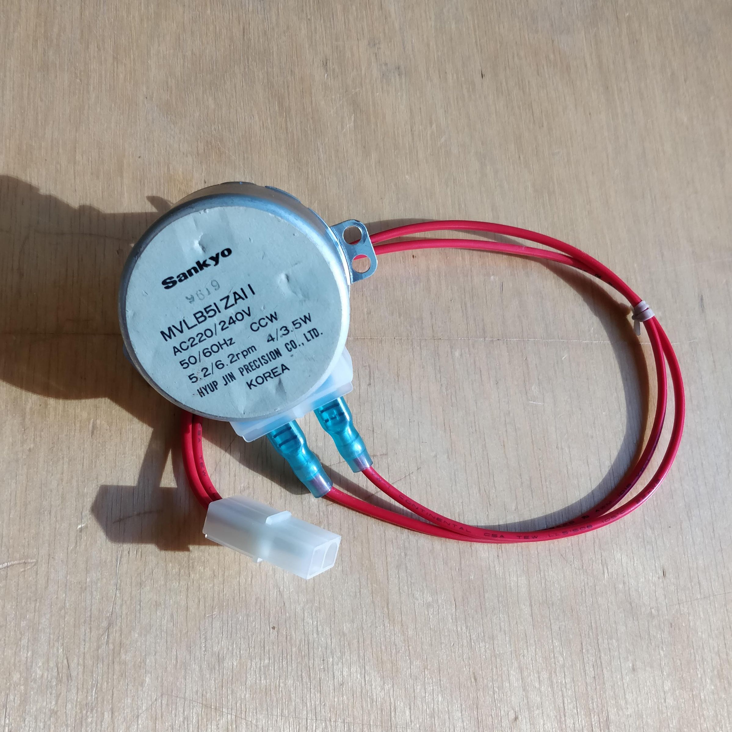

The motor
The most obvious part of the extraction is the motor. This part is exactly located where you expect it to be. At the center bottom of the device. When you have disassembled it, you end up with something like this:

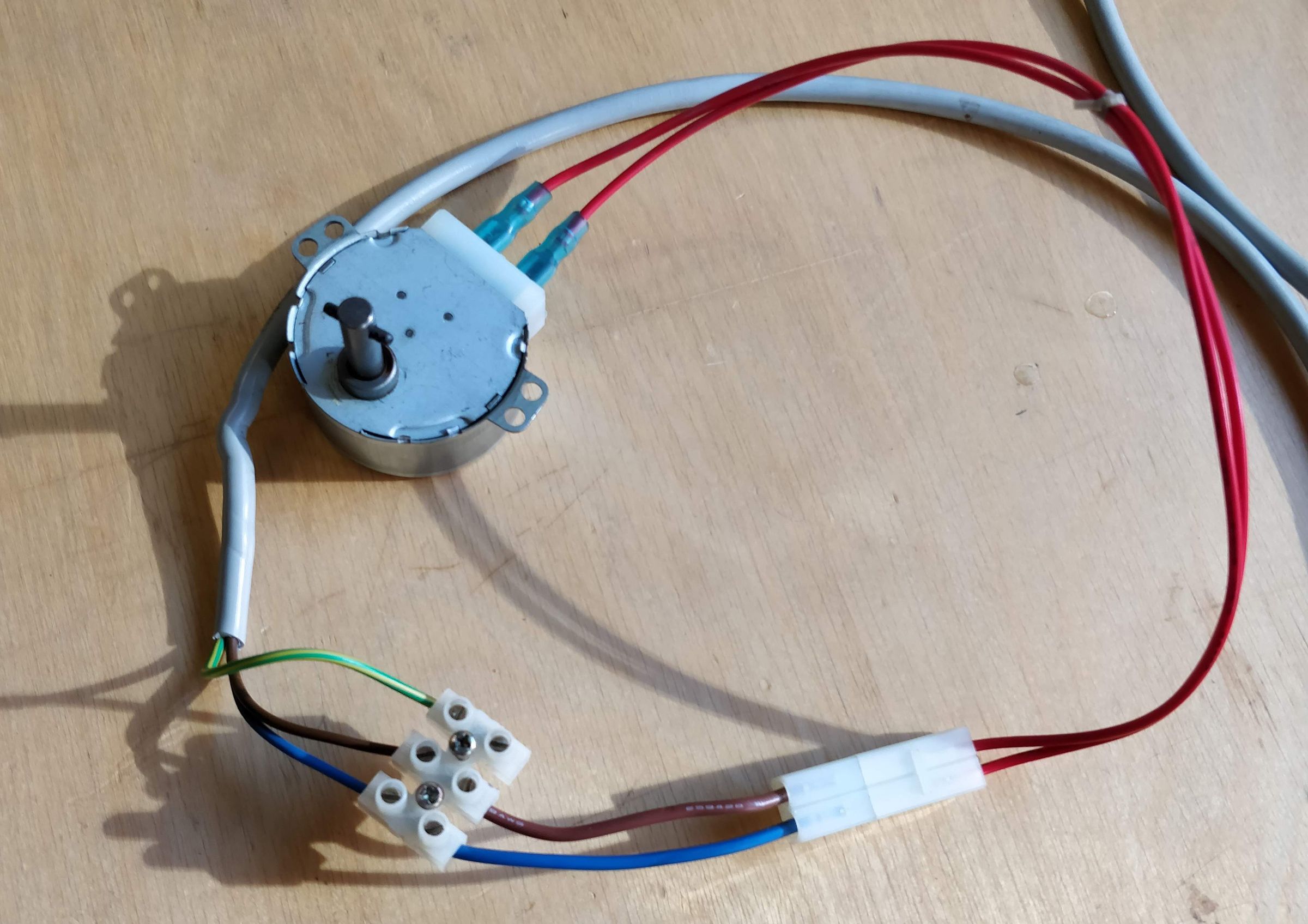

The description of the module says it can be powered directly via a wall plug. AC220/240V. This means that we will need something to power this bad boy.
Power cable
Luckily we have a microwave at our disposal. Which happens to have a power cable. So lets use this cable directly and connect this to our motor. As far as I can tell, it is not possible to reuse these transparent white connectors. By pulling the cables out and put new ones in. But if you are just as lucky as I am. You'll find one of these standard electrical connectors in your microwave which you can use for this purpose.

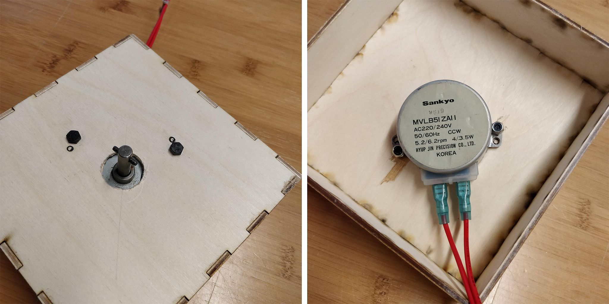

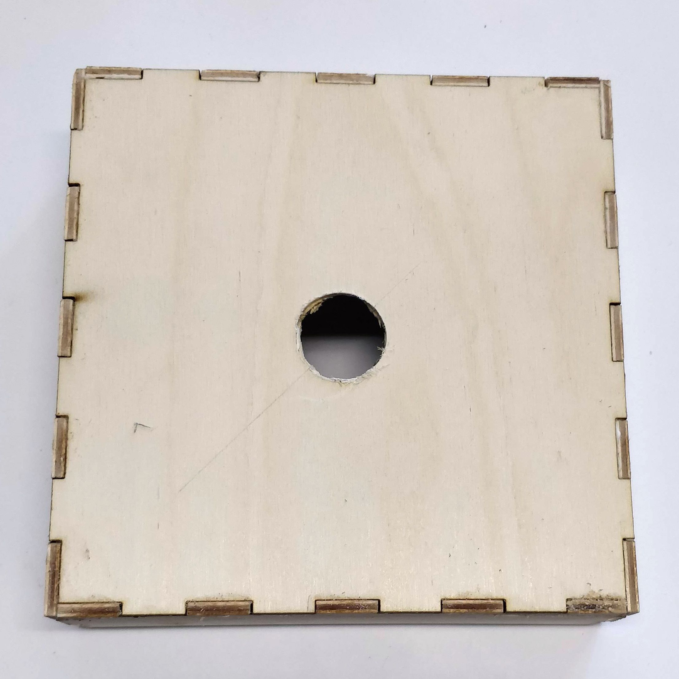

I used a laser cutter for this. But like I already said, anything could be used for this. As long as it is strong and you can attach it to the ceiling. Because I am stupid from time to time and I forgot to edit my box before I laser cut it. You can see the marks of me drilling a hole in the center of the box manually. But I have modified the file - see bottom section - so you do not have to manually drill a hole in the center and a gap on the side for the wires. I am not going to talk you through how to assemble these pieces of wood to form a box
Just make sure that whatever type of box you make. You drill a hole in the center so you can put the motor through it, that it is strong enough to hold the weight of your disco ball and that you can attach it to your ceiling.
Mark the holes manually for the motor and attach it with 2 small bolts. This could be done with the laser cutter but measuring the where these holes should be located is harder than marking and drilling 2 holes manually.

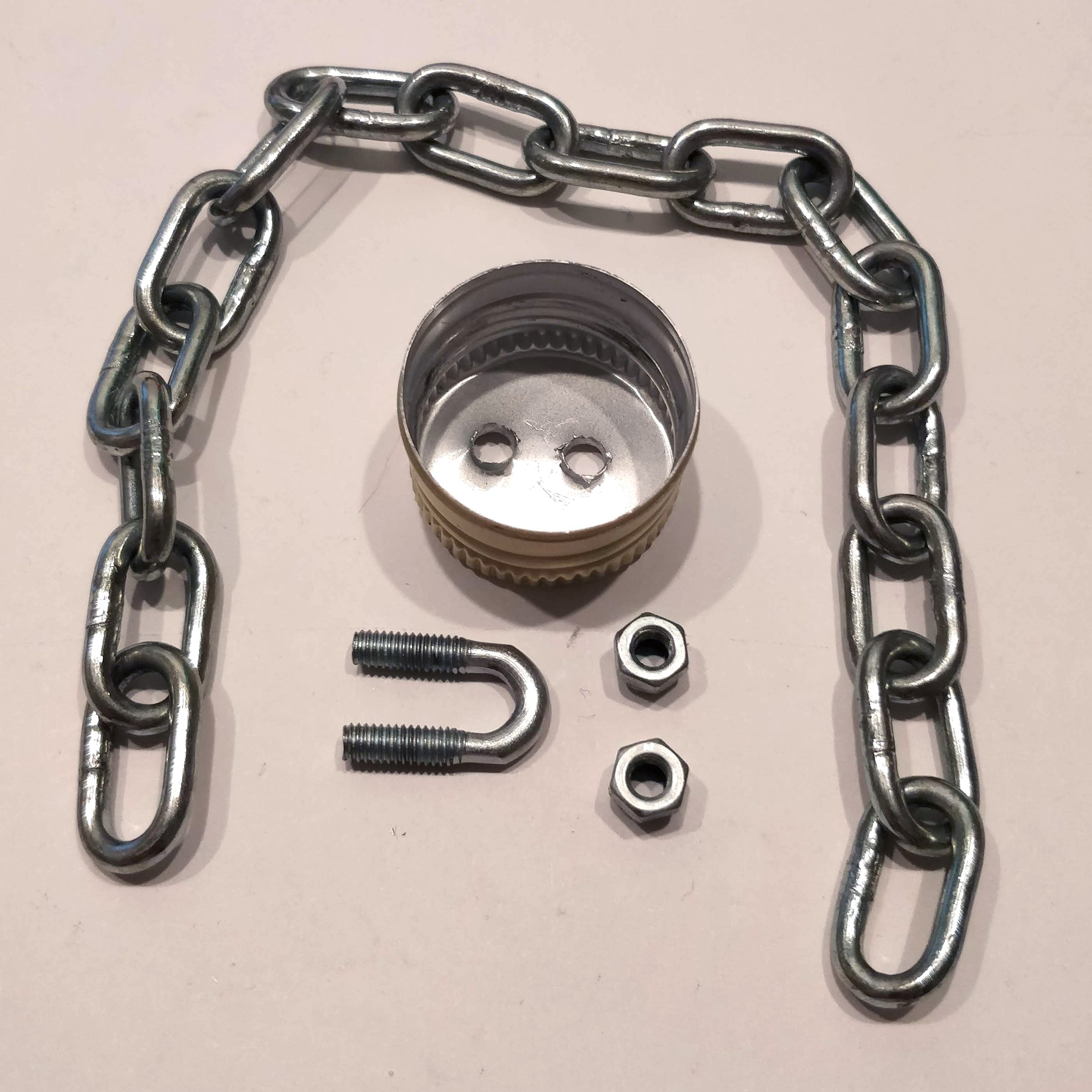

Now our box is ready, we only need to attach the metal chain to the motor with the help of a piece of metal wire. To attach the chain with the bottle I used the materials as shown in the image below. I have no idea how this curved metal thing with threads is called. But the picture is pretty much self-explanatory. Just please do not use hot glue to attach the metal wire with the disco ball. It won't hold the weight and you do not want anything made of glass, drop on the floor from 2 meters high. In case you use the imperial system. You do not want anything made of glass, drop on the floor from 2 meter high. Seriously, just don't use hot glue for this.
That's all. Now you only need to figure out a way to permanently fix it to your ceiling and find a nice way to finish the box. But that's outside the scope of this project. If you foresee a lot of problems with assembling the disco ball to your ceiling or you just don't wanted to make a disco ball hanging from the ceiling in the first place. But just read this section because of politeness. In the next section I will show you how you can make a standing disco ball.

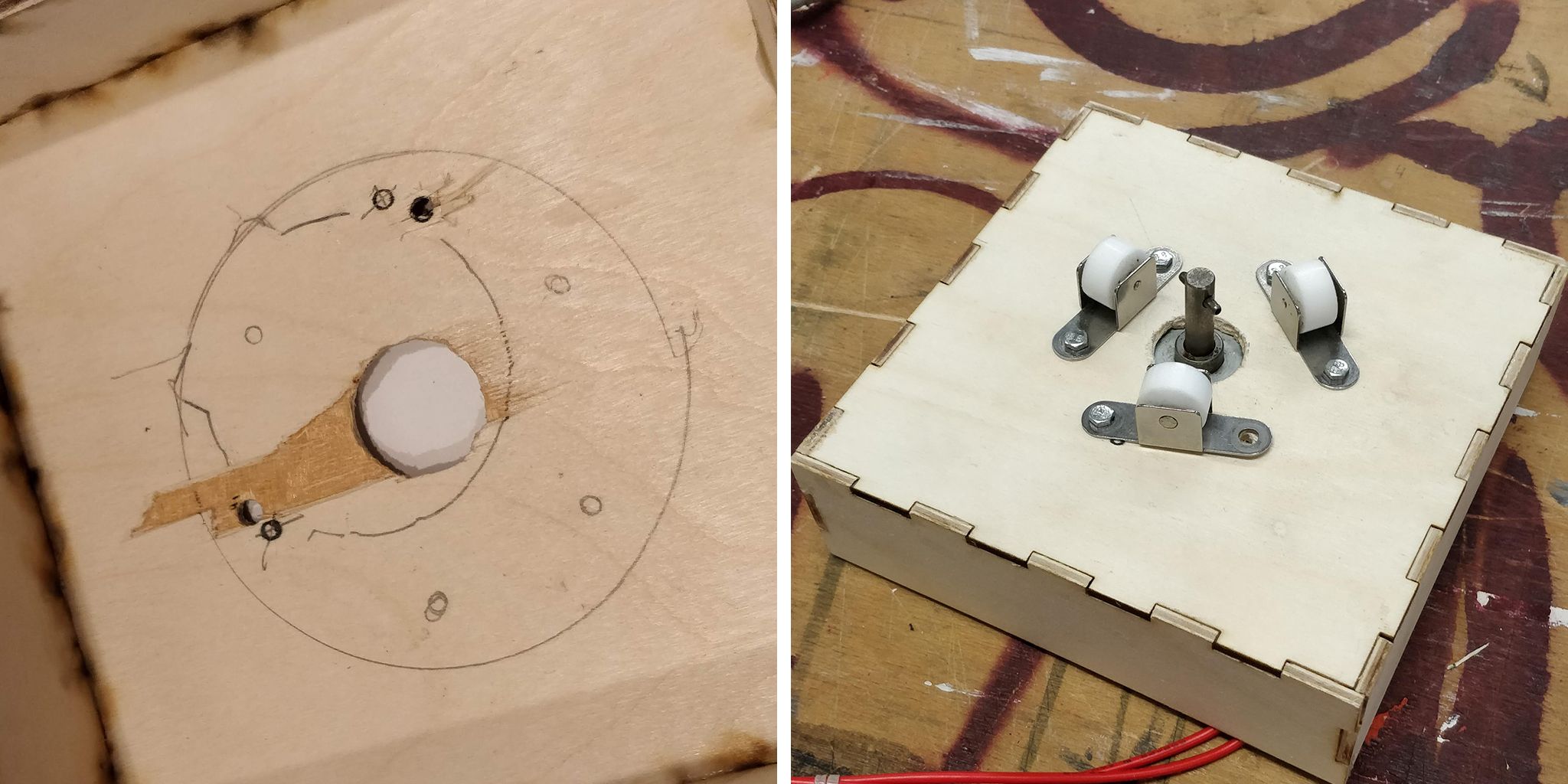

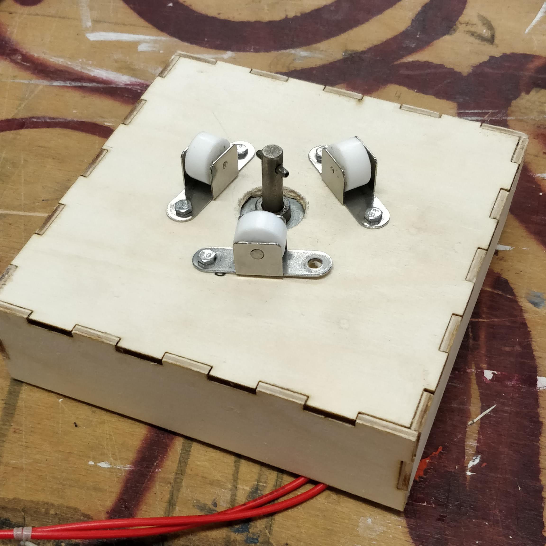

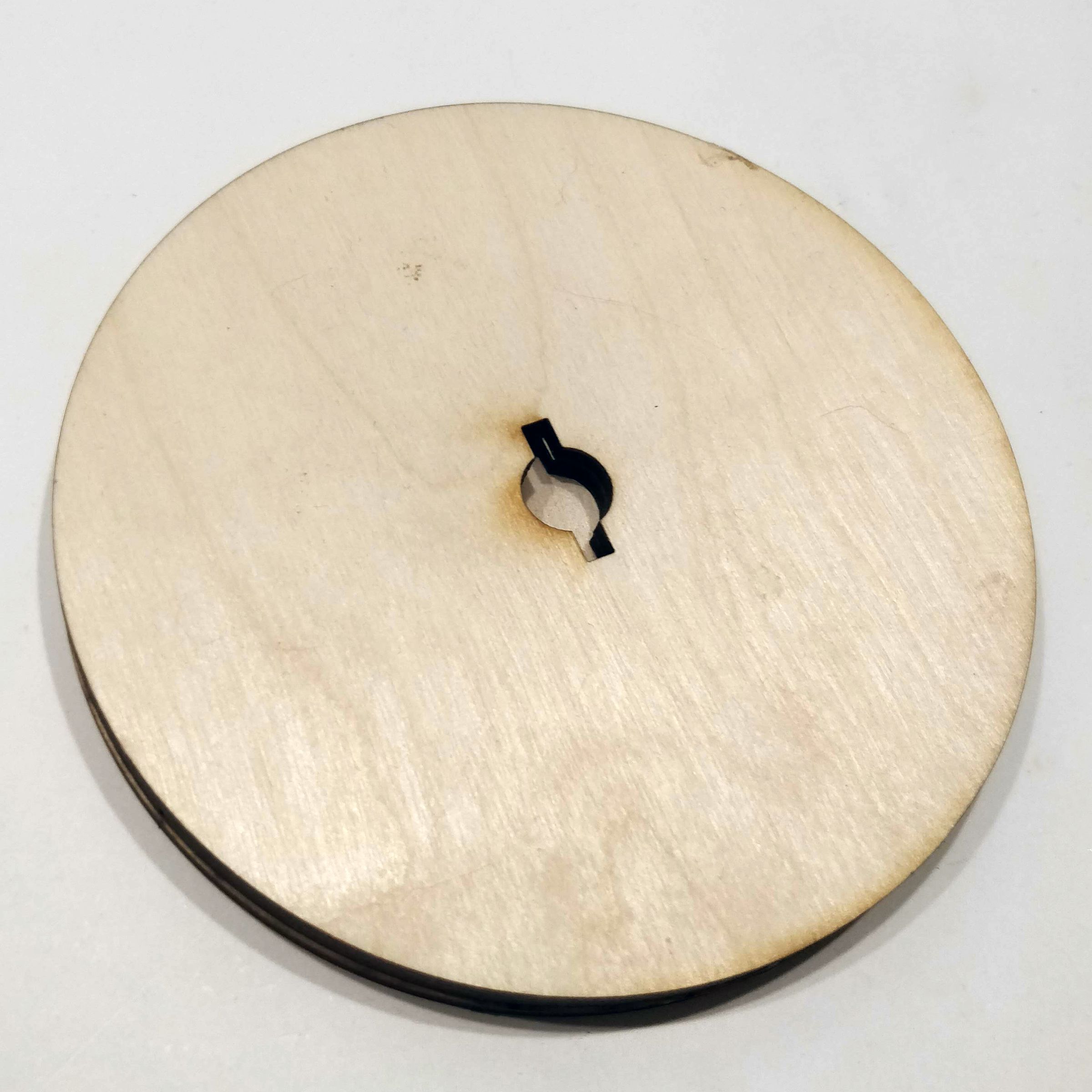

In case you have thrown away the plastic thingy which fits on the motor like I did. You will most likely need a laser cutter to work around that issue. I say most likely, cause you can also just use a 3D printer or use the metal lid of a jar and attach it with hot glue or apply any other creative solution you can come up with. Its all possible. If you have not thrown this piece away you might be in luck, or not. I have really no idea actually at this point, since I can't remember how big this thing was and having a laser cutter at my disposal made me not reconsider using any alternative methods really.
Either way, with a laser cutter you can make a nice plateau which can support whatever you'll put on. I used three layers of 3mm plywood for this. Two of which have a shape cut out in the center, which - sort of - matches with the shape of that on the motor. The third one is just a circle without this hole. All three layers are glued upon each other with wood glue and it works super well. The plateau rests on the bearings. Which makes it nicely balanced.
In case you have access to a laser cutter yourself, the pattern I used for this can be found at the bottom of this section.
If you do not have assembled a casing at this step I'd like to refer you to the previous section.
To put the bearings on the casing you use some small bolts. Two bearings share the same holes as that of the motor. The other one is solo. It is all pretty straight forward, really. When everything is put in place it is actually done.
The glass bottle disco ball I made can be just put on the plateau, no glueing required. If your disco ball can't be put on the plateau because it has a curved bottom, you could glue it to the plateau. If you need to glue it to the plateau because the center mass of your object is not aligned with center of the plateau. You preferably want to strengthen the plateau with the axle. Metal wire? Hot glue? Or make the center mass of your object align with the center of the plateau, so it won't tip over.

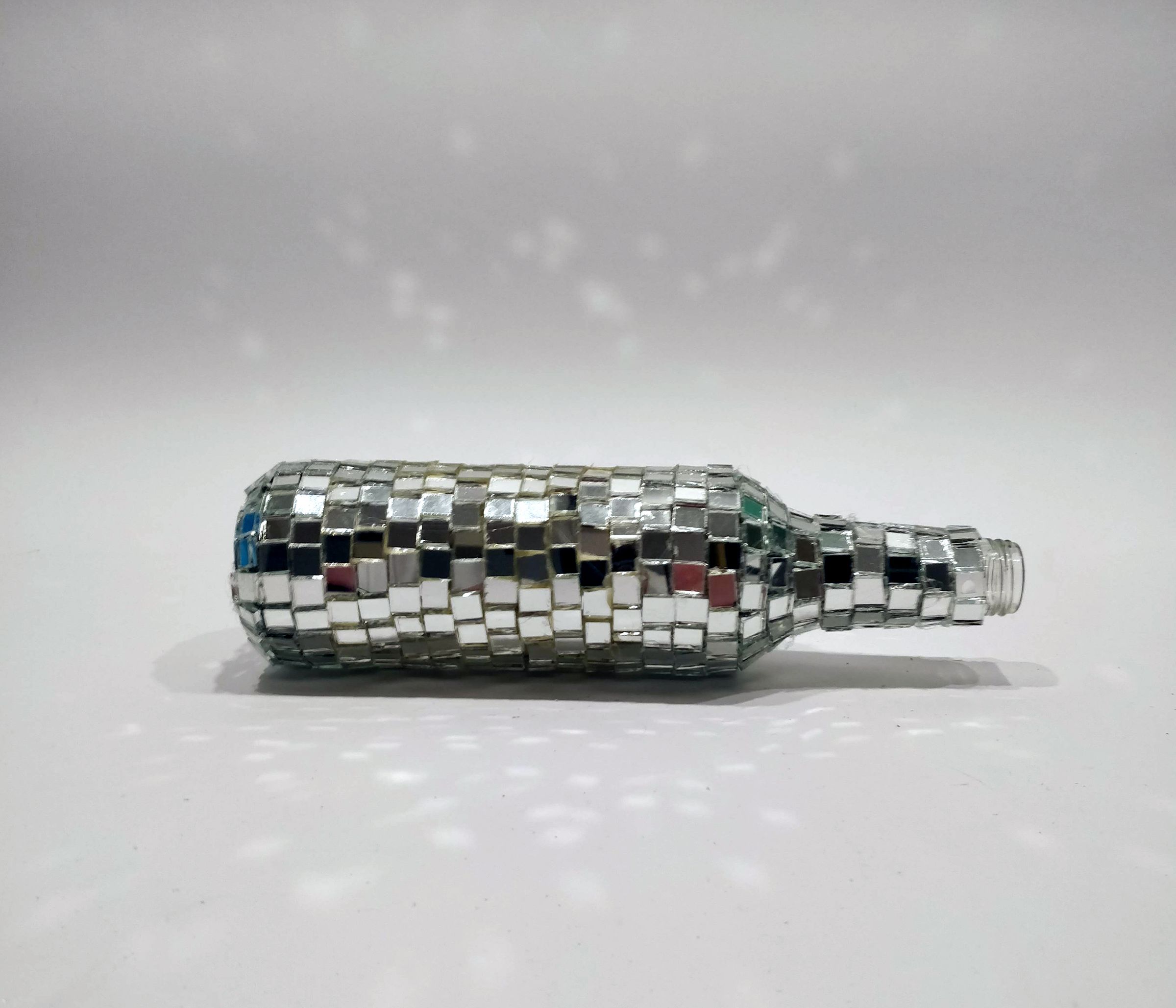

Step 7: My End Result
This fabulous wine-bottle-disco-ball is my personal end-result. It is done messy, with glue all over the place and mirrored pieces which do not align nicely. But with a bit of clean-up and when put in an environment where it really shines (a dark room). You won't notice this at all. Especially since all these details are only noticeable when you look at it from a distance less than 3 foot.
