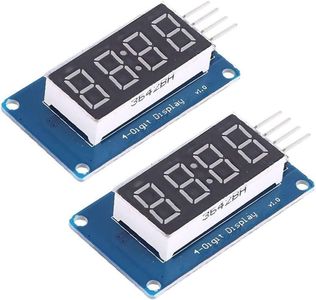

Step 1: One of Two Things
One of two things, you can either buy it how it comes (preassembled) on Amazon, or you can make it yourself. (Here is the Amazon link: Preassembled MAX7219 ). I, personally (as an electronic enthusiast), prefer to build it myself. But that's more of a pride thing. Also, it's the only things I had lying around. Until Christmas, of course.
Step 2: Building It Yourself
Okay, if you are looking at this tutorial, I am assuming you want to build it. If you want it preassembled, then skip the next couple of steps (just jump straight into the code, in other words). To build yourself, there is a few steps we have to follow: taking off the MAX7219 of the dot matrix display and hooking it up to the Arduino/seven segment display. Let's begin!

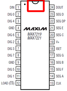

Step 4: Adding It to the Breadboard
The video in the introduction is VERY helpful, by the way. I will be referencing it. I just assumed you watched. Anyway, as I have struggled in the video, you just slap that thing on a breadboard. No, not literally. So, once you put that IC on the breadboard, you can follow my wiring diagram.
If you are not new to this kind of stuff, then, you can follow my schematic. The reason why I am putting both on here is for both beginners and intermediate people. If you are at the advanced level, I am sorry to tell you, you WILL cringe.
Anyway, allow me to explain myself on my wiring stuff. The latter has +5V on a step-down buck converter. The GND is, well, GND for both the Arduino and +5V buck converter. They are daisy chained. *An important note - put the notch/divot forward (meaning, pin 1 should face "up").*
The rest is pretty simple: you hook up the segment according to the left and right side of the chip. (Which, by the way, is numbered 1-24). One starting at the top left of the chip (which is on the left of the divot). The segments go on the right side of the chip and go to each segment "location." Such as, A goes to, you guessed it, Seg A. This is because each thing called a segment is put into place on the actual display.
Seg A is the first segment or "line" and is in the middle of D1. You can research more on that theory, if you want, as I am not going to go over that. I am not THAT good at explaining the theory behind it.
Anyway, here's the trick: the digital pins go on the left side, BUT they go from DIG0-DIG7! So which one do you choose? The easiest (and what makes the most sense to me) is the DIG0, DIG1, DIG2, and DIG3. In other words, hook it up in that combination, and you should be fine. The rest is history.
Hey, by the way... I also forgot to mention that +5V. Yeah, that's pretty important. You HAVE TO USE +5V or there could be catastrophic consequences. Heath my warning...
Oh, yes, one more thing: I think you have to use the digital pins on some Arduinos. Don't quote me on that 'cause I am not that sure. I have an Arduino Mega 2560 rev3, so... I can't speak for that.
