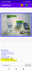

  • ESP32-CAM will drive OV2640 to capture images (VGA resolution) in real-time continuously
  • the captured image will be sent to DumbDisplay app [for caching]
  • ESP32-CAM will draw the cached image on DumbDisplay app
  • Like in parallel, ESP32-CAM will drive DumbDisplay app to perform object detection on the cached image
  • When ESP32-CAM receives the object detection results, it overlays the object markers on the image shown.
By default, it connects to DumbDisplay app via Bluetooth with name ESP32Cam.

Two "graphical layers" combined (one on top of another) are used for showing the captured image and the object detection markers

  • objectLayer (overlaid on top) is for showing the object markers
  • imageLayer is for showing the captured image
The loop logic flow is basically like
    if (captureAndSaveImage(false, true)) {
imageLayer->drawImageFileFit(imageName);
int x = objectDetectResult.left;
          int y = objectDetectResult.top;
          int w = objectDetectResult.right - objectDetectResult.left;
          int h = objectDetectResult.bottom - objectDetectResult.top;
          objectLayer->drawRect(x, y, w, h, "green");
          objectLayer->drawStr(x, y, objectDetectResult.label, "yellow", "a70%darkgreen", 32);
