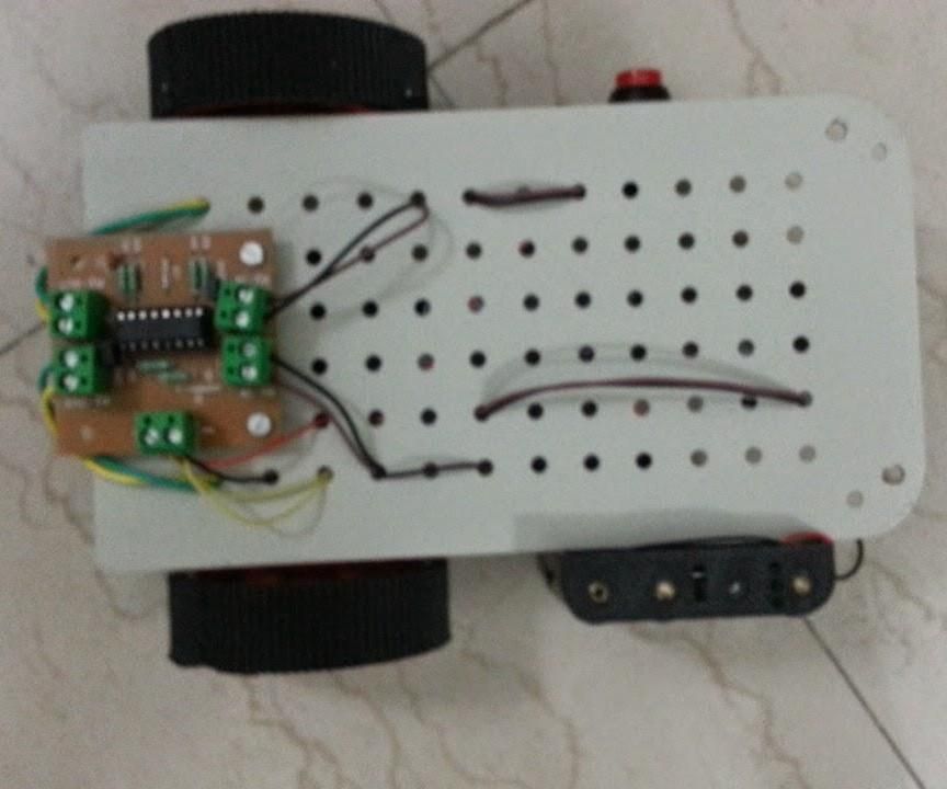

Step 10: Motor Driver Kit Has PWM to Control Motor Speed
Close up of the motor driver kit shows EN pins which are used for PWM (Pulse Width
Modulation) i.e. to control the voltage to the motors their by controlling the motor speed.
I wanted the enable to be high i.e. full voltage to be given to the motor to make my
program easy. I did not have a jumper and wanted to complete my Model2 robot today so made
one through the 2 yellow single strand wires which I soldered to the EN pins
Step 11: Enable Pins Shorted Through Homemade Jumper

Step 14: Motor Driver Kit Connected to Arduino
Motor inputs connected to Pin8 to Pin11 of the Microcontroller. I can control the
logic level of these Pins thus control the HIGH (Logic 1) or LOW (Logic 0) value being
shared with Motor Input connections thereby control not only the direction of current and
hence direction of the motor but also switch the current to motor ON or OFF thus start or
stop the motor
Step 15: The Motor Output Connections on the Motor Driver Kit Are Connected to Cables Connected to the Motors
Step 16: Both Boards Placed on the Chassis
Placed the 2 boards on the chassis with bubble wrap under it to ensure the metal chassis does not short the boards via the metallic underside of the board (metallic due to soldering.)
